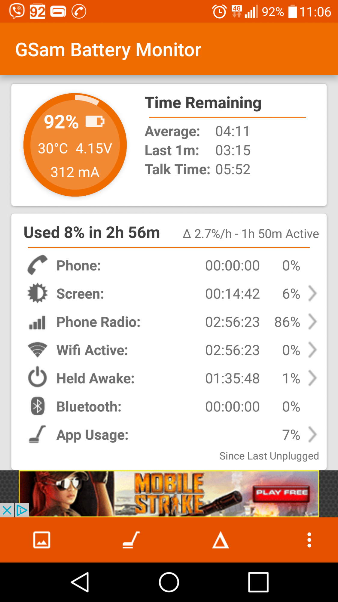

Battery drains when it wants to. Sometimes it doesn't but sometimes does this. This morning I woke up, read the news on the phone, went to work and almost didn't touch it. After a few hours I saw this and made a screenshot.
