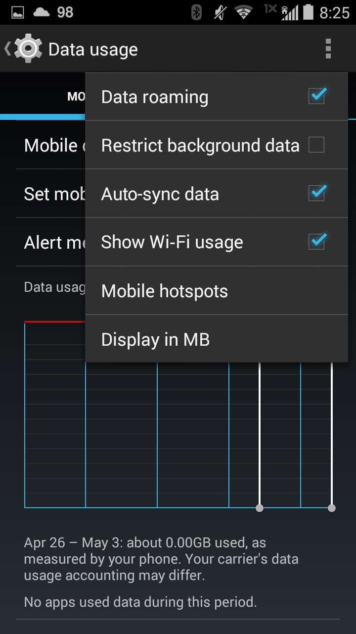

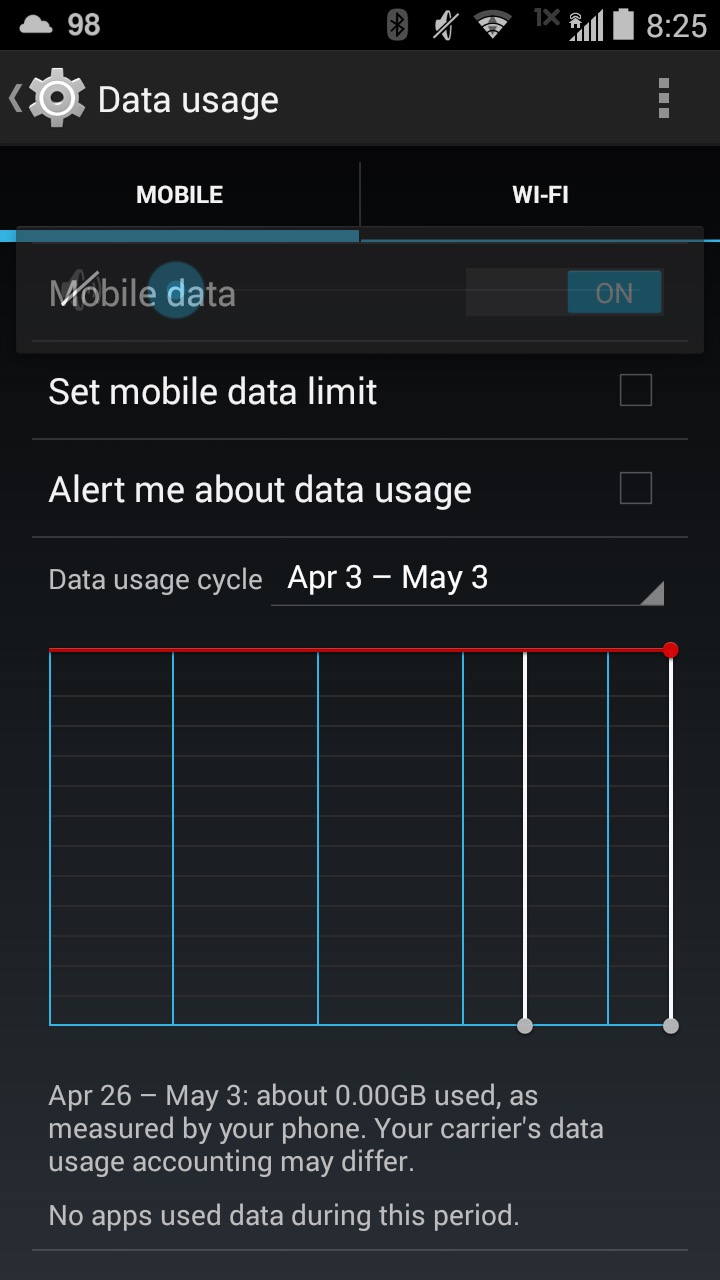

To follow up Jfalls63, go into the settings app and then data usage. Here are screenshots of that plus what you see when you tap the menu control top right.
So, you want Mobile Data turned on, and maybe make sure that the settings in the overflow menu match this.
