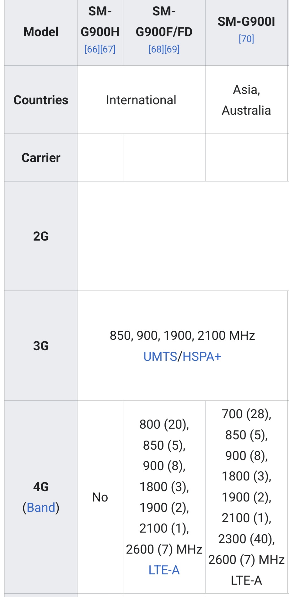

Well there are some S5 variants that don't have 4G/LTE modes in them, e.g. the SM-G900H variant.
Of course we don't know what S5 variant the OP has, or which carrier, or country they're in. But if they have a SM-G900H variant, they might be SOL.
The SM-G9009D variant also lacks 4G/LTE, But that's a China Telecom CDMA version of the S5.
