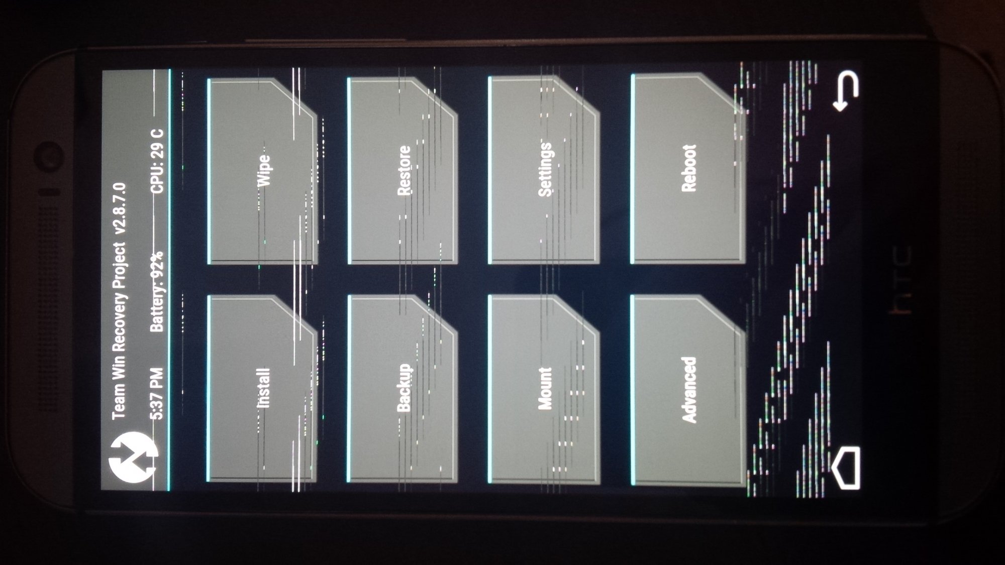

Here's a few photos of TWRP failing - tried it again this morning and it actually got slightly further, to about 28% restoring system before it failed with an ExtractTarFork() error 255. This same error happened a few times while trying to restore my own backup a few days ago as well. When it crashes it sometimes restarts itself it seems, but the TWRP screen then has artifacts all over it.
When TWRP appears to restart afterwards:
Sorry the pics are wrong orientation, the uploader on this site flips them around for some reason.

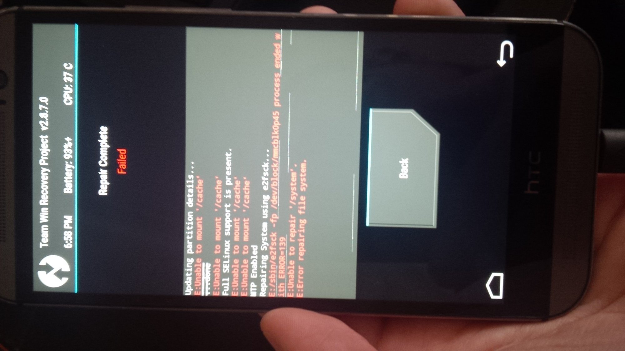

TWRP errored trying to repair /system (first partition I tried) with similar display artifacts. I didn't try actually reformatting it yet:
I pulled the recovery.log via ADB - I've uploaded the whole thing but the pertinent lines appear to show that it caused a seg fault:

I:eek:peration_start: 'Repair Partition'
Repairing System using e2fsck...
I:Repair command: /sbin/e2fsck -fp /dev/block/mmcblk0p45
Segmentation fault
E:/sbin/e2fsck -fp /dev/block/mmcblk0p45 process ended with ERROR=139
E:Unable to repair '/system'.
E:Error repairing file system.

Should I just try and go through reformatting each partition anyway? It can't break things any further than they already are I guess?
The 'fastboot erase cache' is fine. I was hoping to get the log of the failed restore, but good that the adb pull command worked at least.
Yep go through the format partitions - you can see from screenshot that TWRP has failed to mount the cache partition so something wrong with partition(s) level.
