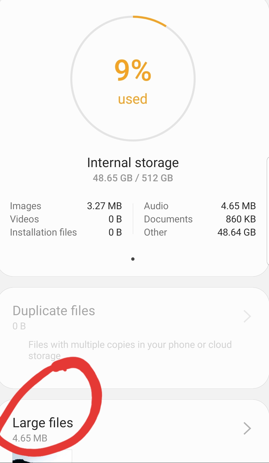

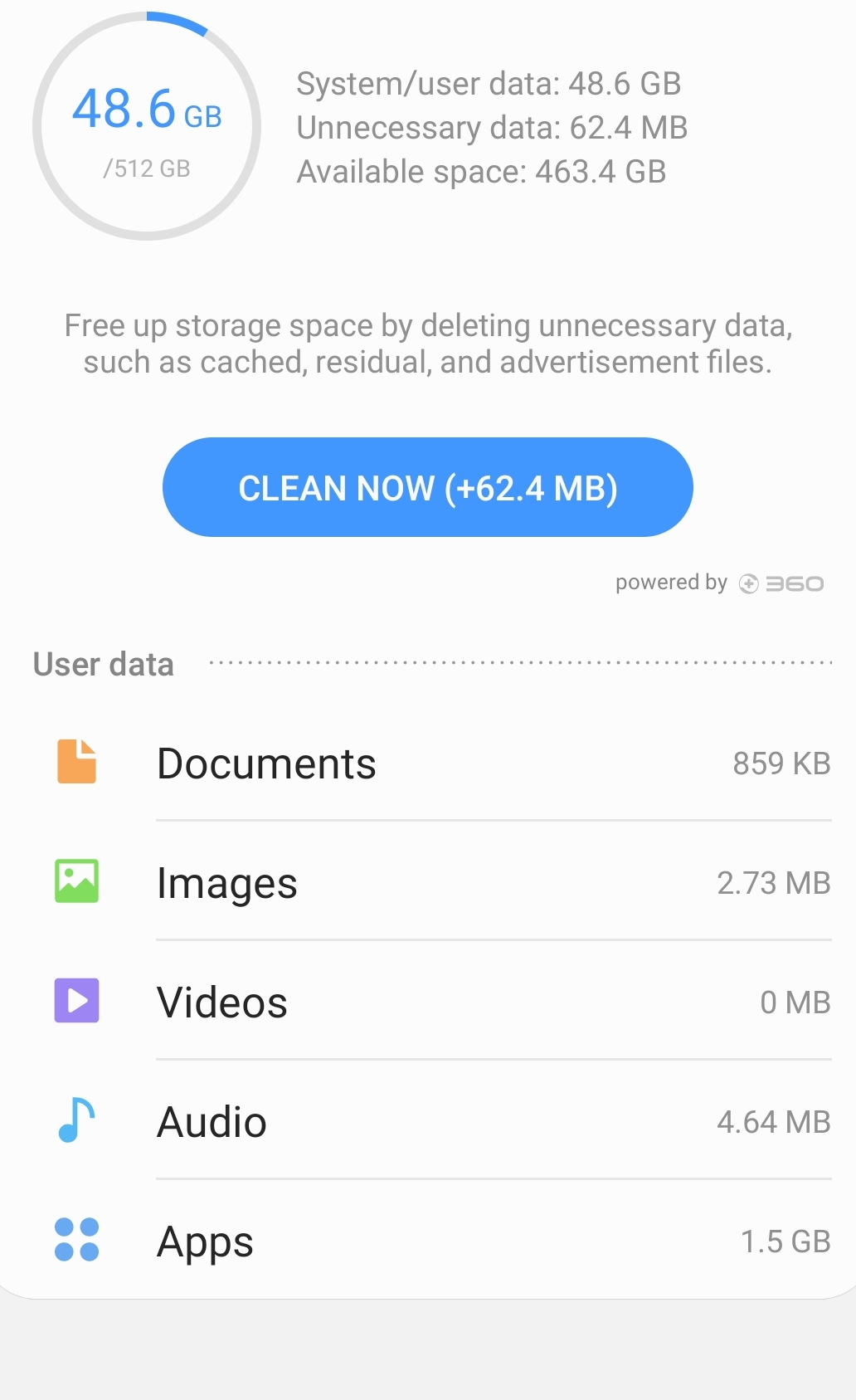

Hi, thank you very much for your answer.
I cannot find any significant content in the device, just the few pdfs that I have already downloaded (4 pdfs of less than 10 pages each) and the biggest archive that I find is a preinstalled mp3 of 4,65MB that was already in the phone.
I upload here some pics for providing some insight about my situation:
Here a pic of my situation:

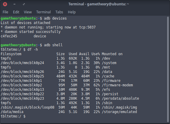

Not that this will help you, but something you should know anyways. Considering android is basically linux, just use the df command to check partition sizes, used space, and leftover space.
With your phone plugged into your pc run the following adb commands...
Bash:
adb devices
adb shell
df -h
As you can see from the screen shot my system partition is 3.4gb, system used 1gb, and have 2.3gb left.
