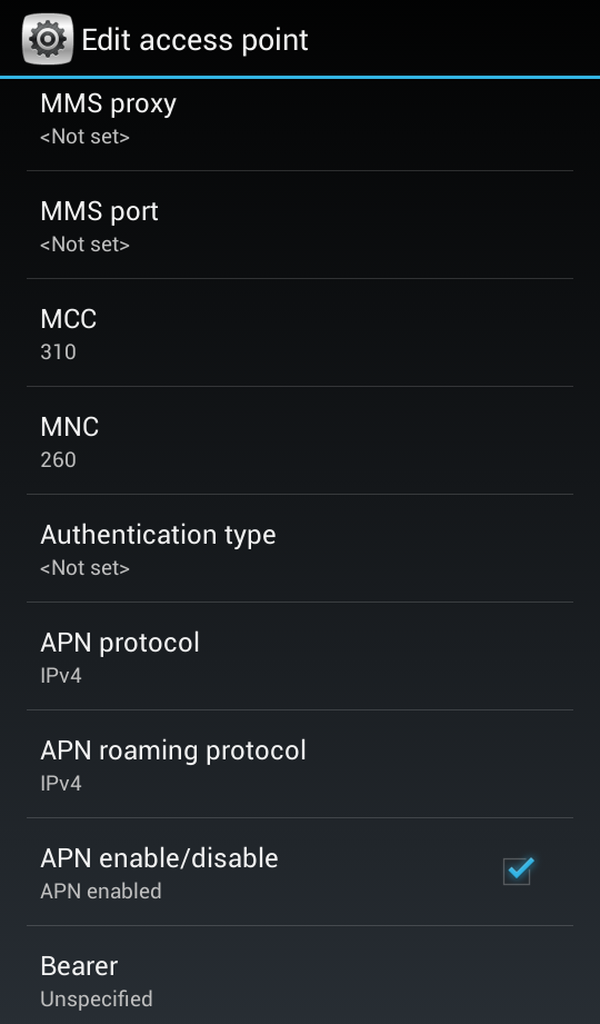

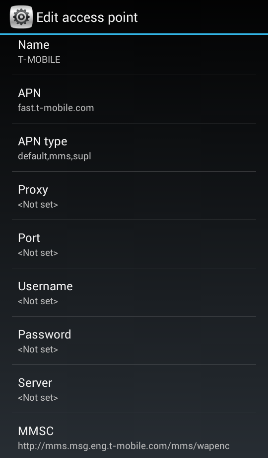

Here is what I have it set to. I have tried epc.tmobile.com. I have tried setting the MMS port to 80 and 8080. I can't add to the apn type because there are only radio buttons for mms, default, and supl, but I did try modifying the Univision apn on the SIM because it it listed fota and hipri in the types--didn't work.
