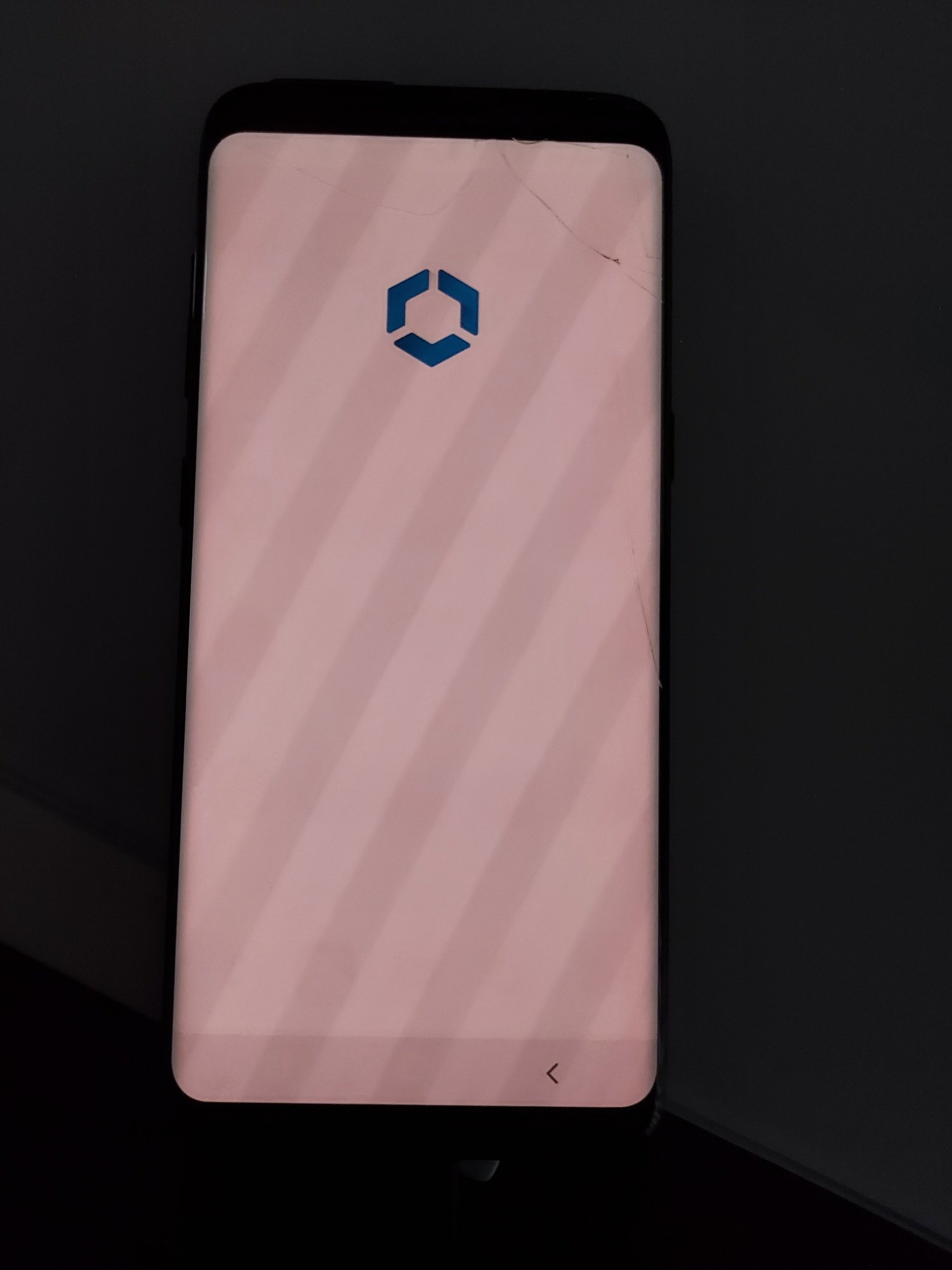

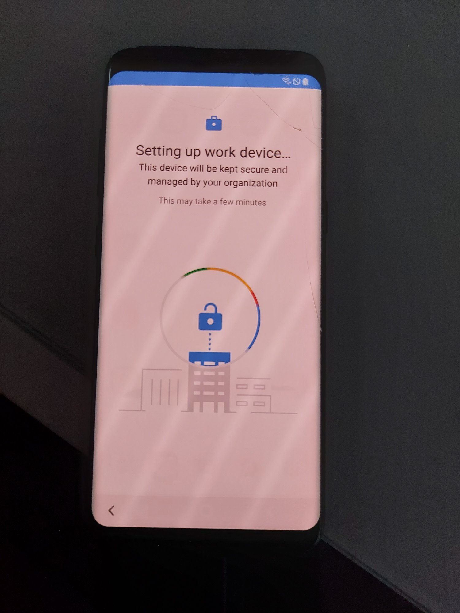

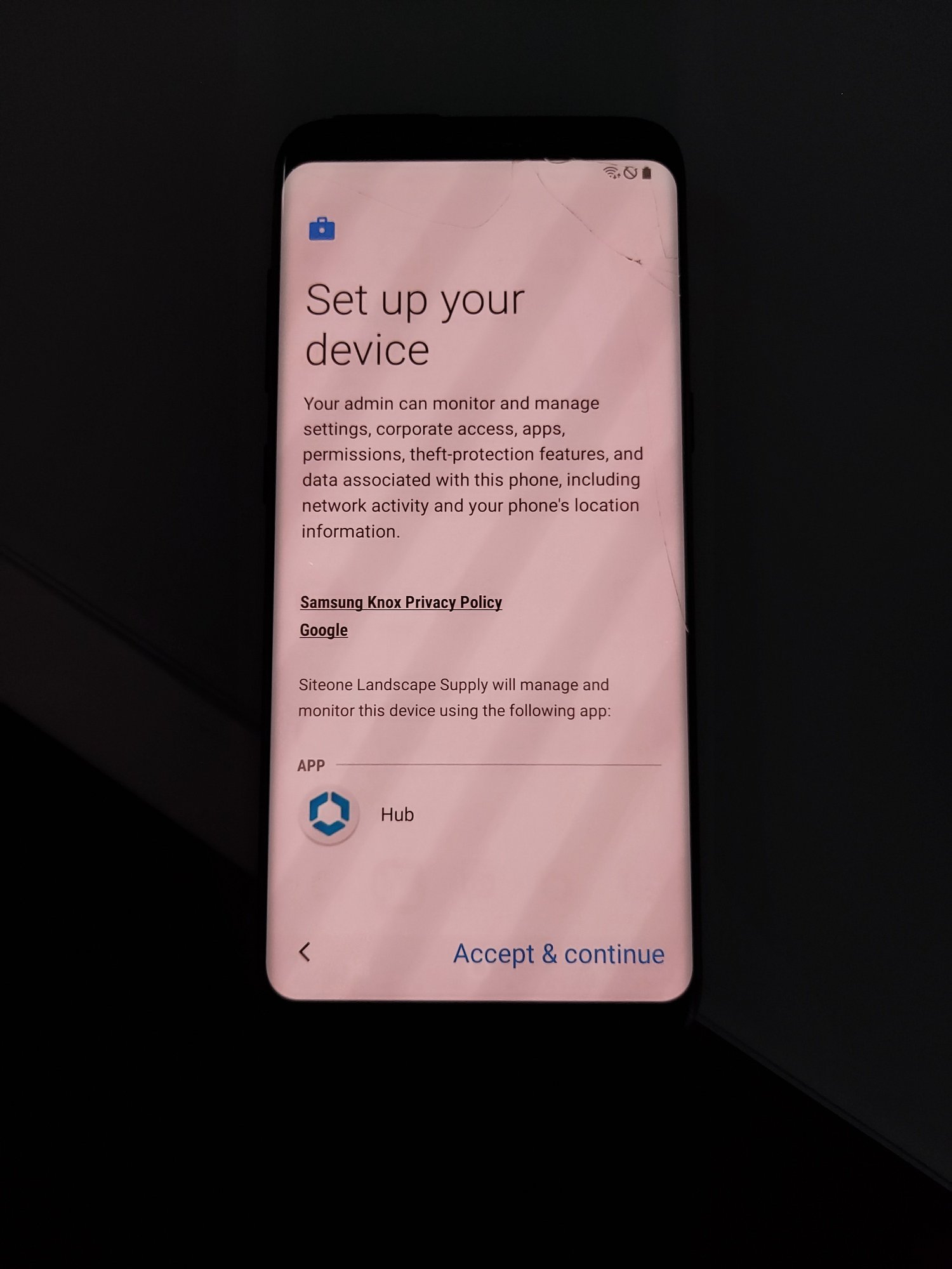

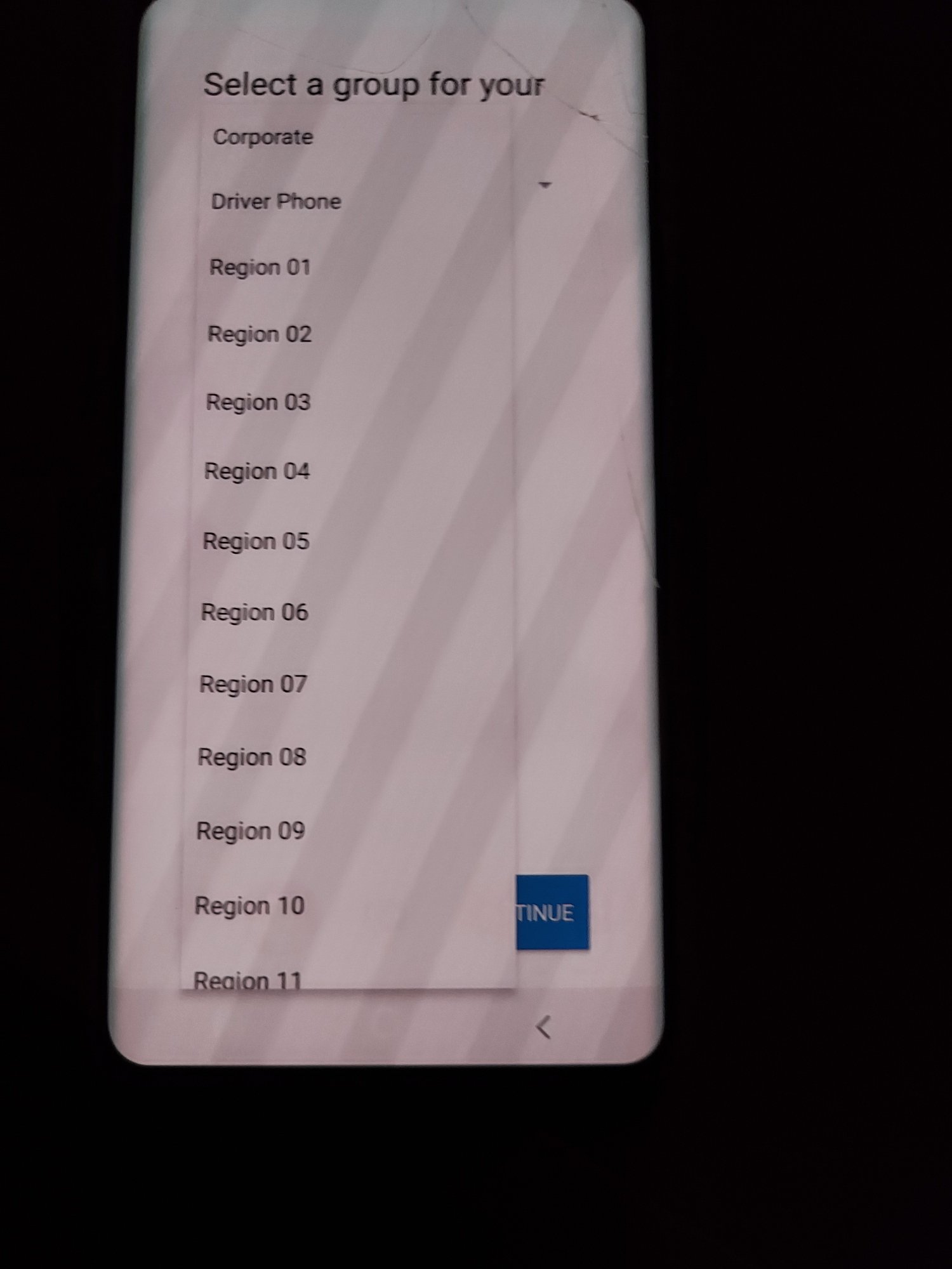

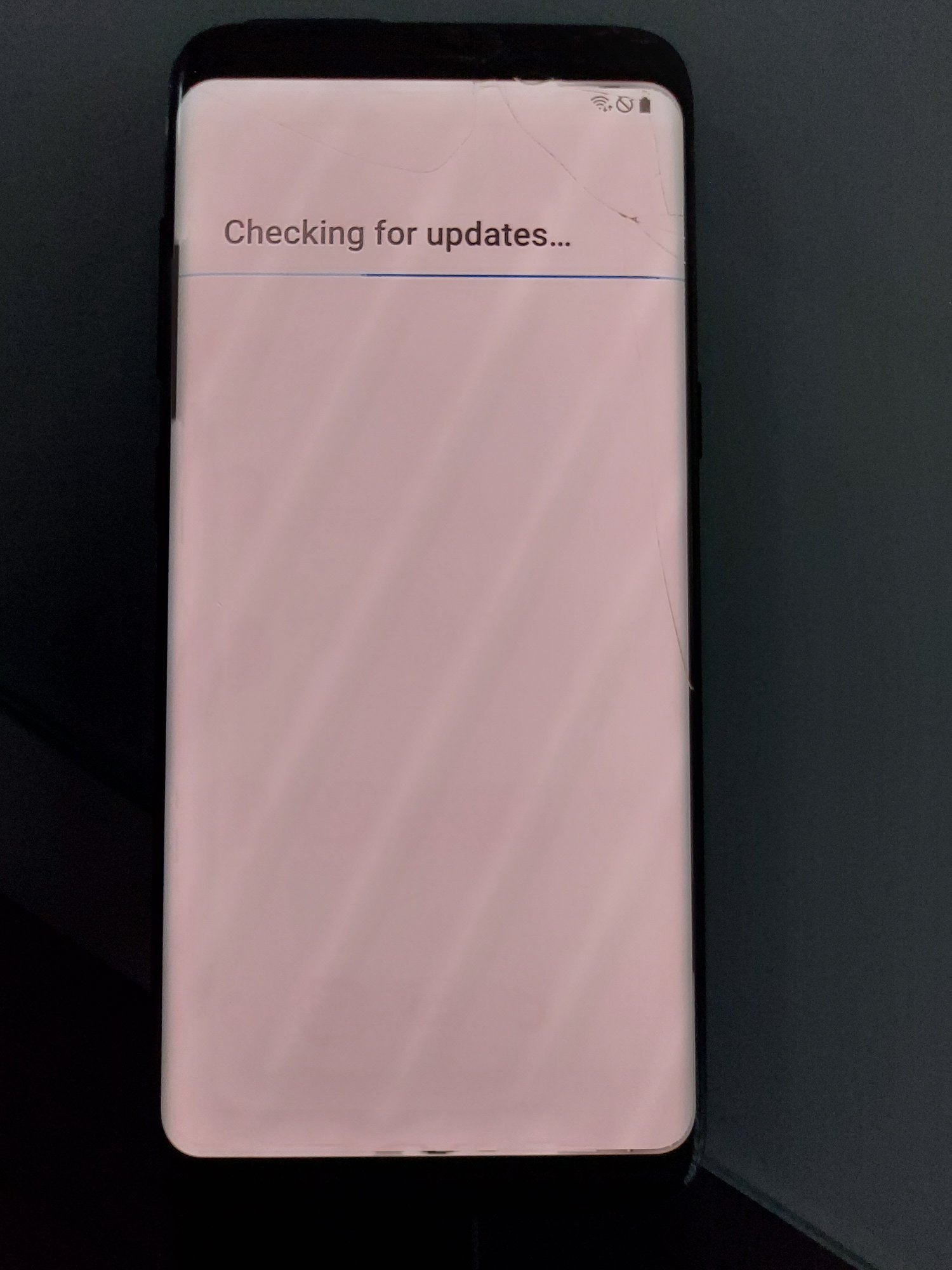

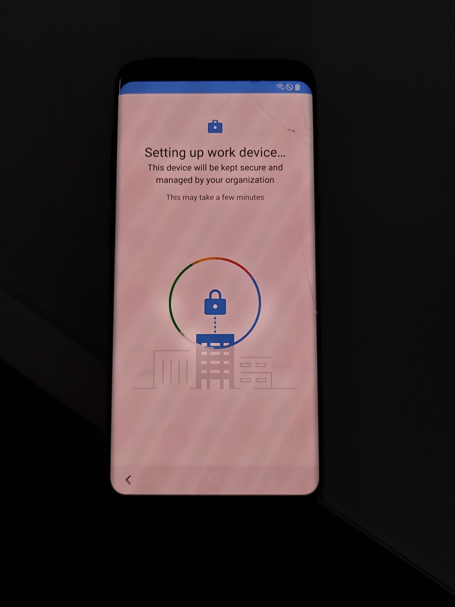

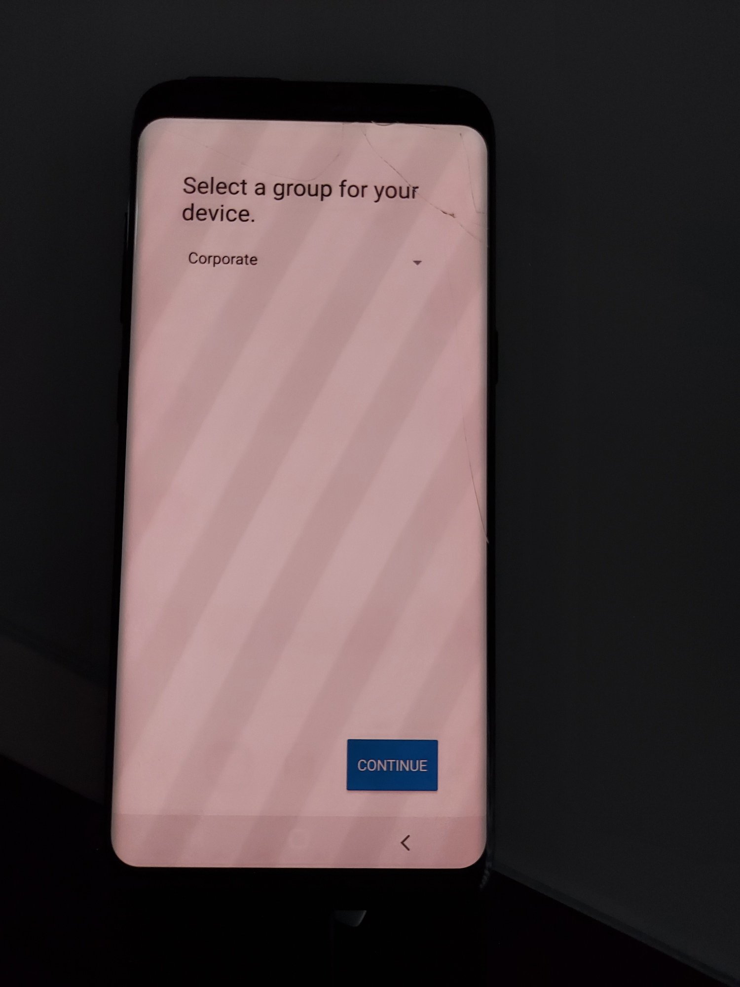

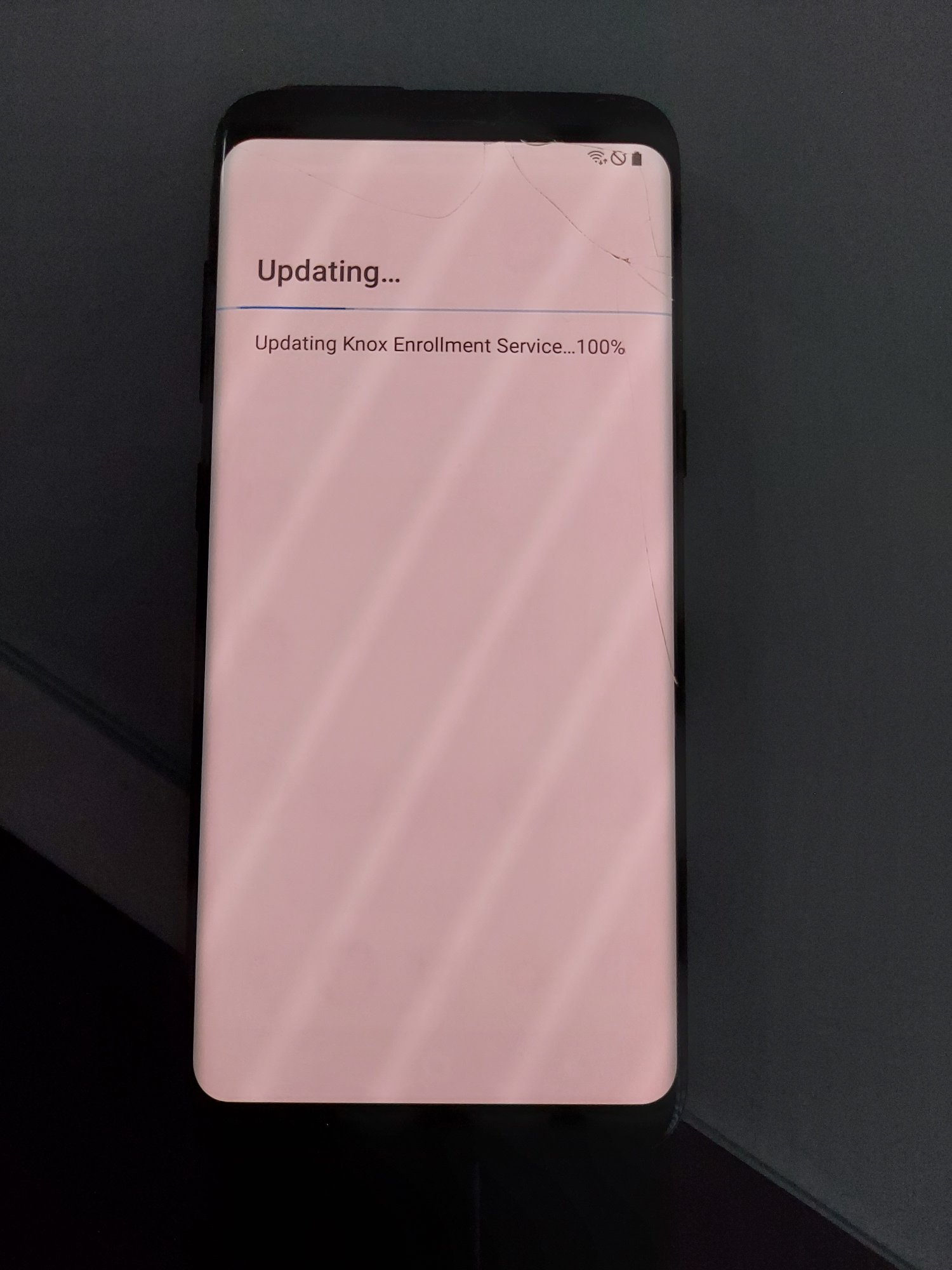

20201207_170441.jpg 20201207_170449.jpg 20201207_170521.jpg 20201207_170526.jpg 20201207_170532.jpg 20201207_170543.jpg 20201207_170554.jpg 20201207_170609.jpg 20201207_170554.jpg 20201207_170609.jpg 20201207_170650.jpg 20201207_170655.jpg 20201207_170658.jpg 20201207_170703.jpg
I was pretty new at the factory reset process, so I went to the settings inside the phone and clicked thru the factory reset buttons!
on your photos, did you proceed further? looks like there is a drop down menu so you can change it from corporate to something else. just curious as to what the choices are?

Yes, I opened the drop down, there was corp site, many portal sites and Email edit site. I tried my google and samsung account info in each. All returned a error for mismatched info. Figured since it shows as SiteOne corp site, that I was off base. I tried to contact Siteone several times, vut it seems like they are as frustrated with Verizon as I am. They are no longer Knox customers and may be out of business.

To be a little more informative. I originally did a factory reset, thinking that it would only return my phone to the original newest format with out all of the apps that I had downloaded over the last year couple of years. After that is when I discovered the problem. I have tried many things and researched how to try and reinstall the firmware. Also checked if the Knox fuse has been broken, but from the boot screen it shows as the warranty is still valid. So somehow this phone is stuck in-between the enterprise Verizon set-up and private ownership?
