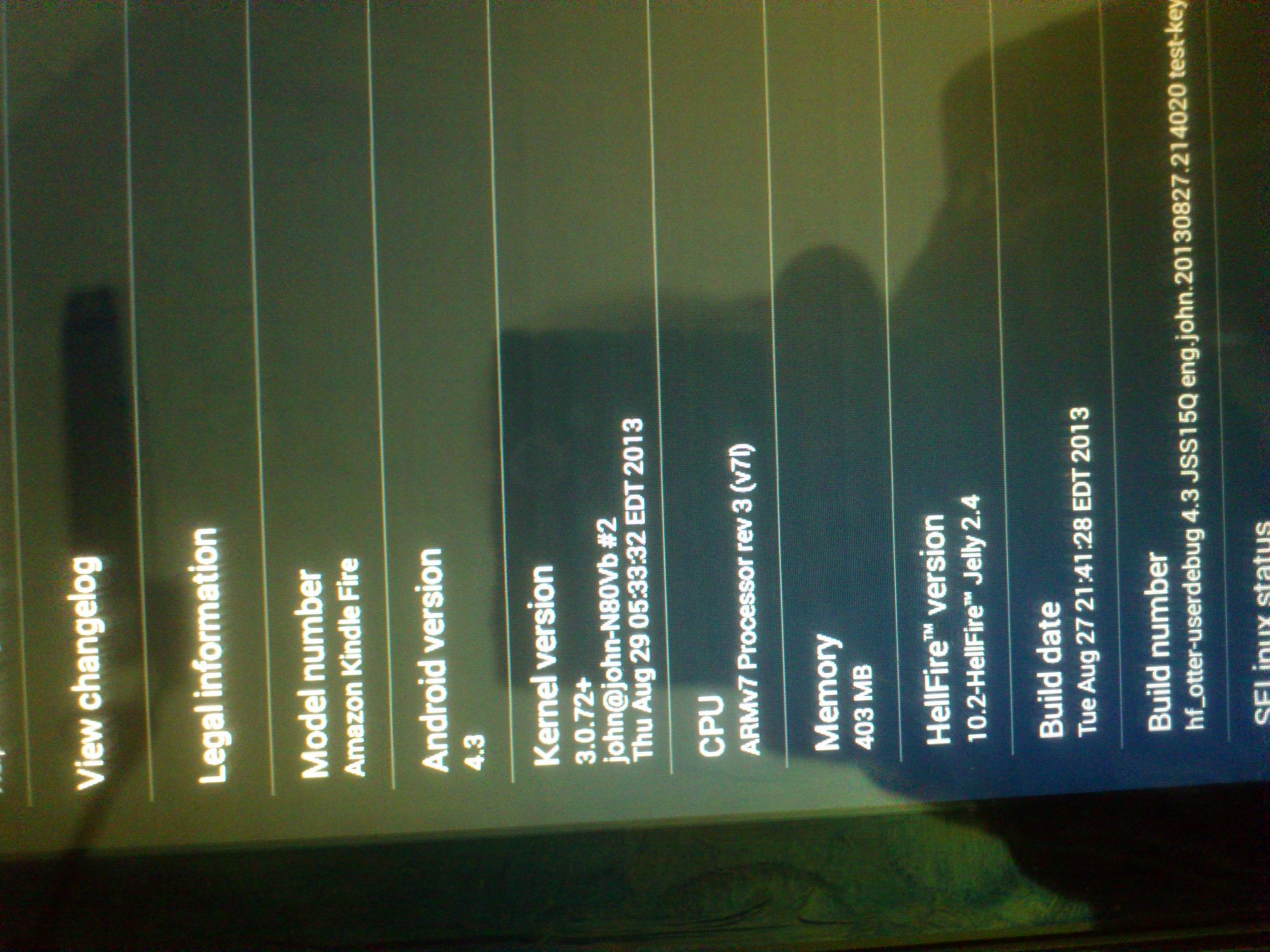

Info about unit:
Android 4.3 - HellFire version 10.2-hellfire"Jelly 2.4 Kernel version 3.0.72+
build number hf_otter-userdebug 4.3JSS15Q eng.john.20130827.214020 test-keys

However the tablet was first rooted and if you refer to my first post I indicated the following:
Hope this helps?
Regards,
