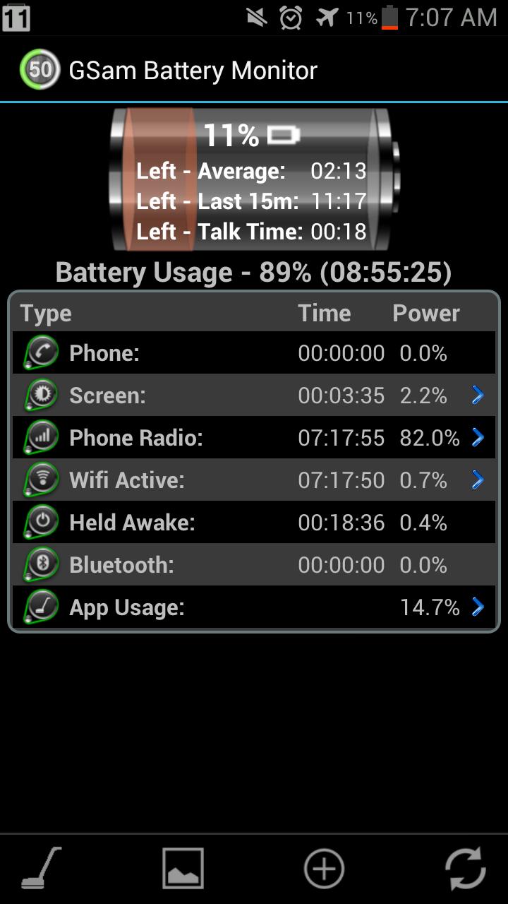

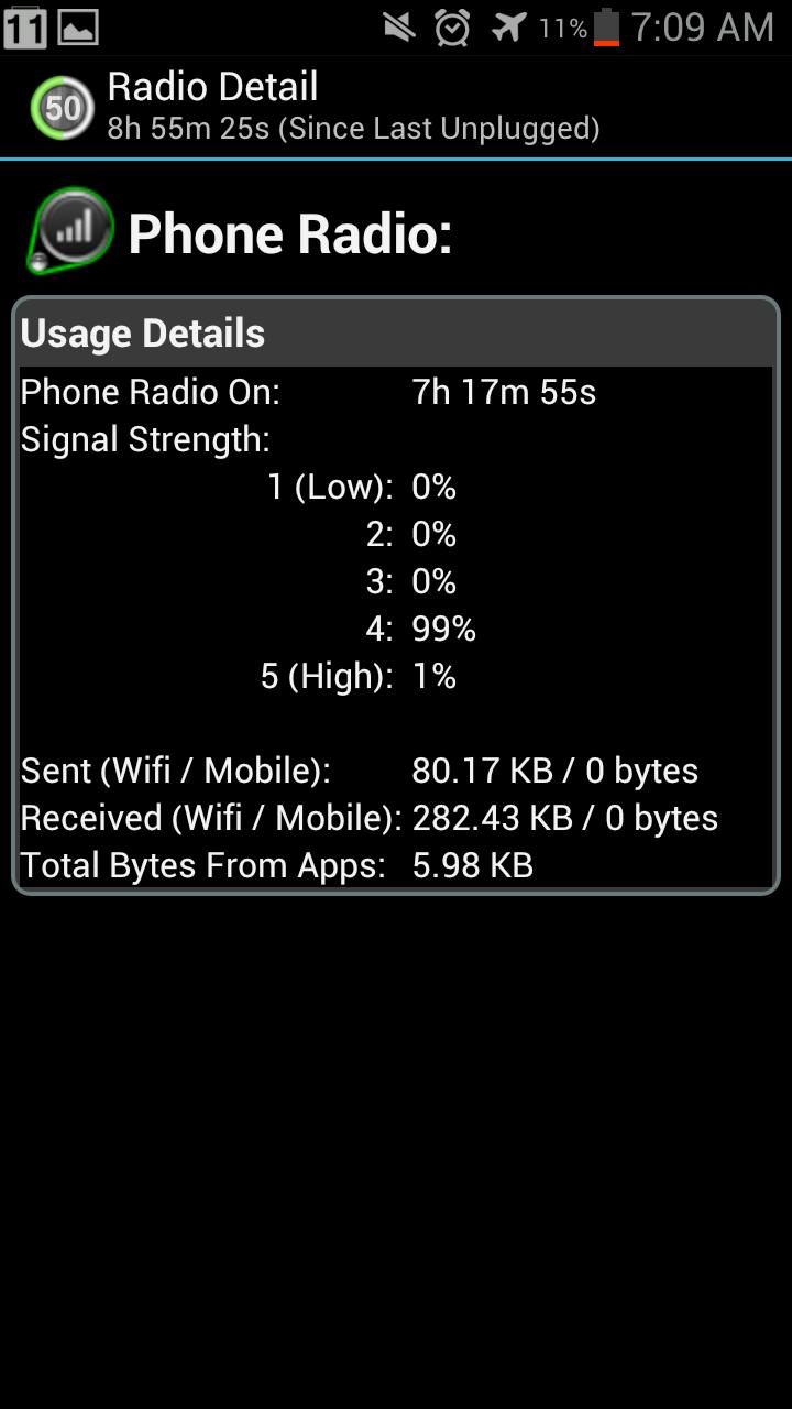

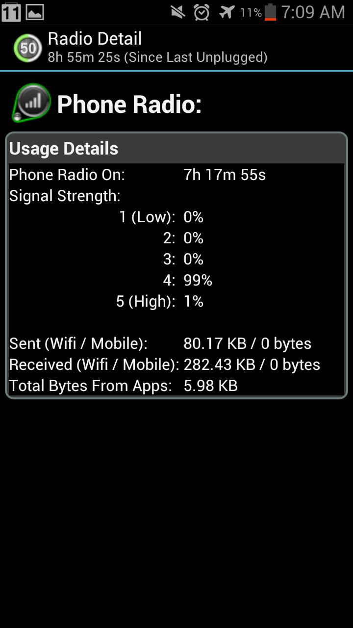

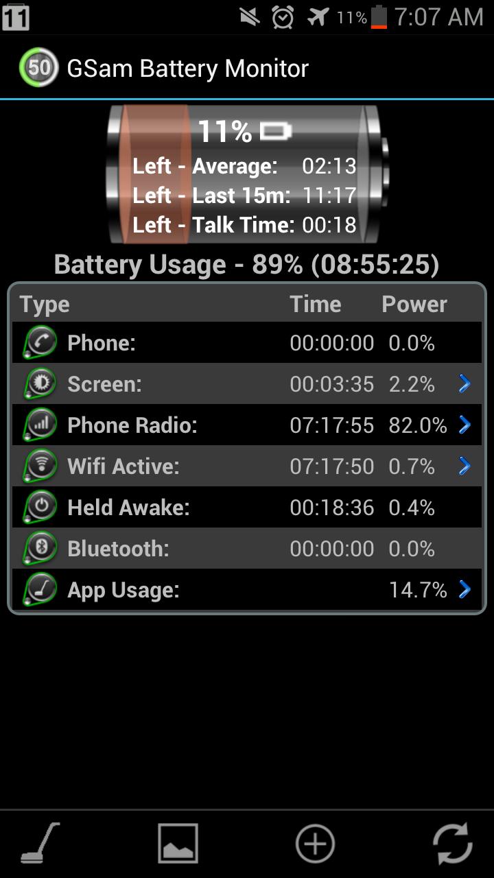

Since you seem to know a bit about batteries, maybe you can help me with my problem. I go to bed fully charged every night and wake up with 0-5% battery. It doesn't matter what combination of Wi-Fi/Syncing/Mobile Data/etc, that I use. I always just seem to end up with an almost dead battery.
So I downloaded GSam and this is an example of the results it gave me...
As you can see, cell radio is what takes up my entire battery. But as you can see from the other picture, I have no trouble getting reception. So what is the cause? If it was a rogue app running in the background, wouldn't it show up under "apps" rather than radio? And even if it WAS a rogue app, can it seriously be responsible for that much?
EDIT: And if you're wondering why airplane mode is on, it's because I awoke in the middle of the night to find my battery low so I turned airplane mode on to ensure it didn't die in my sleep. So basically airplane mode was only on for an hour or so, so don't be mislead by the icon lol. Airplane wasn't on the whole night.
This should be on as different thread. But I'll try and help.
You may have a bunk phone because with a strong signal like that something is really wrong. Download phone info and use it to try a different band. 3g vs 4g or whatever applies. Google more info.
If you try and return it they will make you factory reset first. So it is probably worth trying that as well
The cell standby is a known issue and will skew your stats.
http://androidforums.com/samsung-ga...andby-issue-please-sign-petition-samsung.html
Try putting it in airplane mode overnight (this should turn the radio off) after it's fully charged, then post the results, incl. the app page. Also check the "view time held awake" and " view num times waking device" values. Hopefully this might shed some light on what's actually going on.

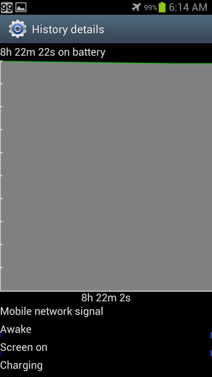

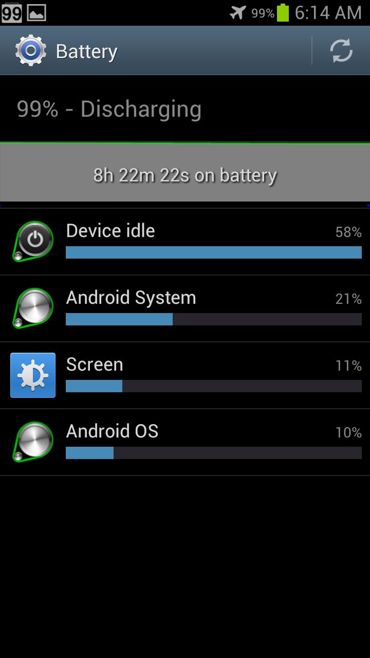

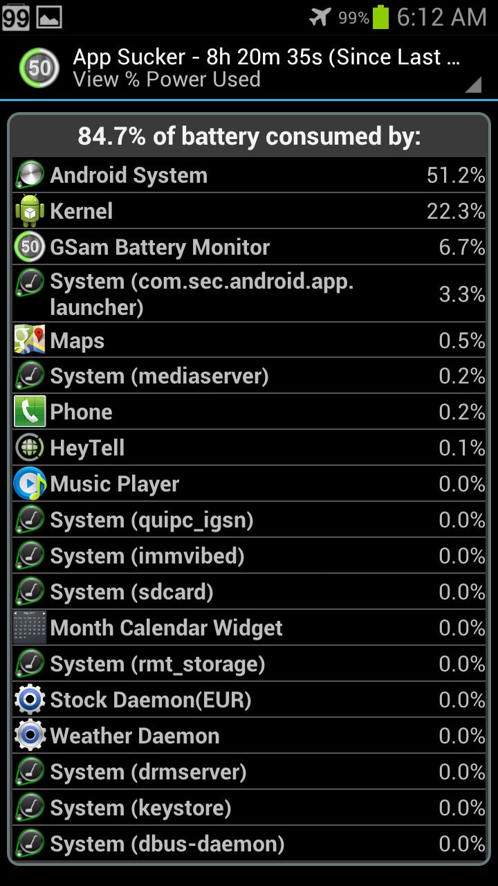

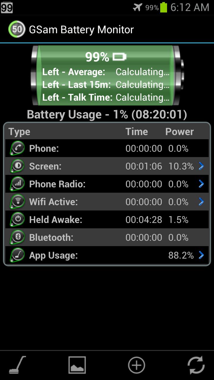

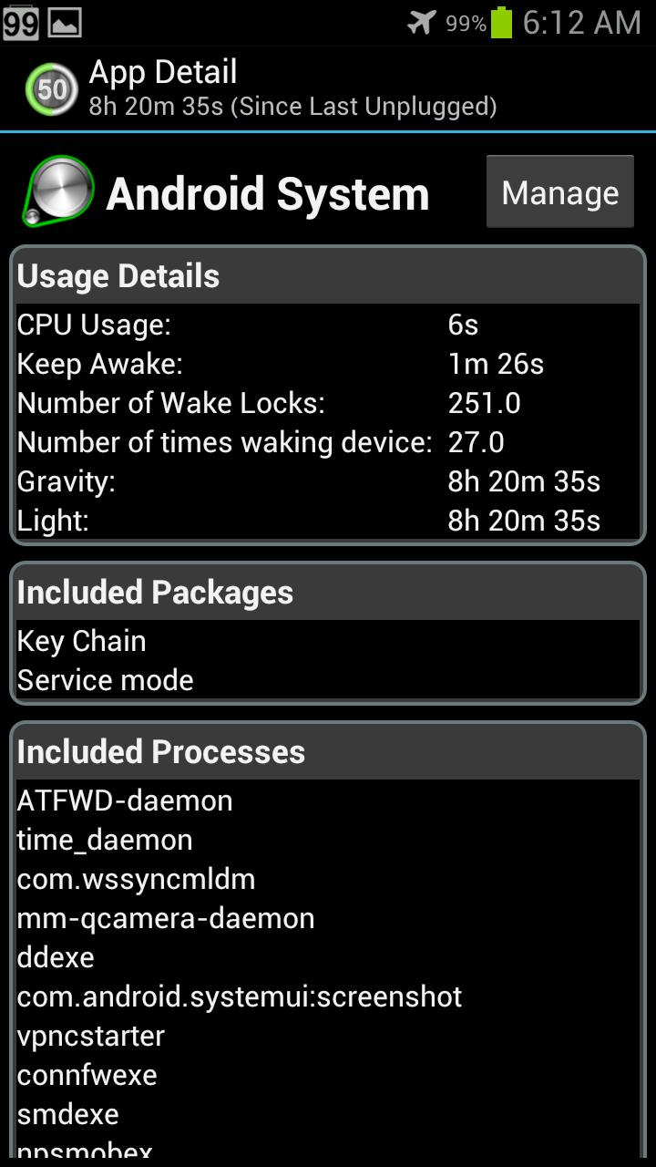

Okay so ran it in airplane mode all night (and of course that was when all the action went on. woke up to 3 texts, a score center update, 3 fb notifications, and an email lol)
Now THIS is a number I like. Woke up with 99%
So I check GSAM
88% of that 1% is attributed to apps... so onto the apps...

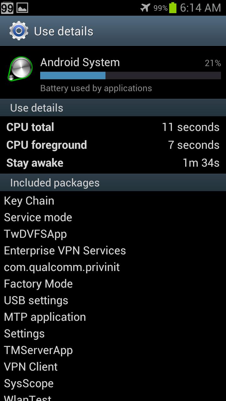

Android System is responsible for 51% of that... so onto that...
I feel this is the most important snapshot of the series. This reveals the wakelocks and whatnot
The above is a snapshot of the setting's battery usage thing built in
I'm noticing my phone wasn't awake during the night according to this lol. I like this!
Here is a different snapshot of Android system. I like GSam's better
Anyway, that's the results. What's the next step? What do these pics reveal?
