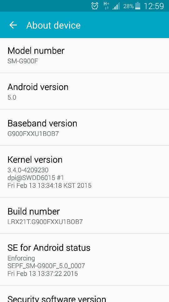

This is my device
This is my device
That does not show your CSC code as per #1.8 of 35 Galaxy S5 models - know yours???...
#1.8. Your FIRMWARE
To locate your current firmware version, (not baseband/modem), go to the dial pad and type in...
*#1234#
This will give you your, "Version", details in full, usually 3 lines of information which are all relevant. The important one to note in this case is the first, "AP:", (a.k.a PDA), detail. This is important because, as previously mentioned, some models have had a number of updates and improvements to their original firmware.***

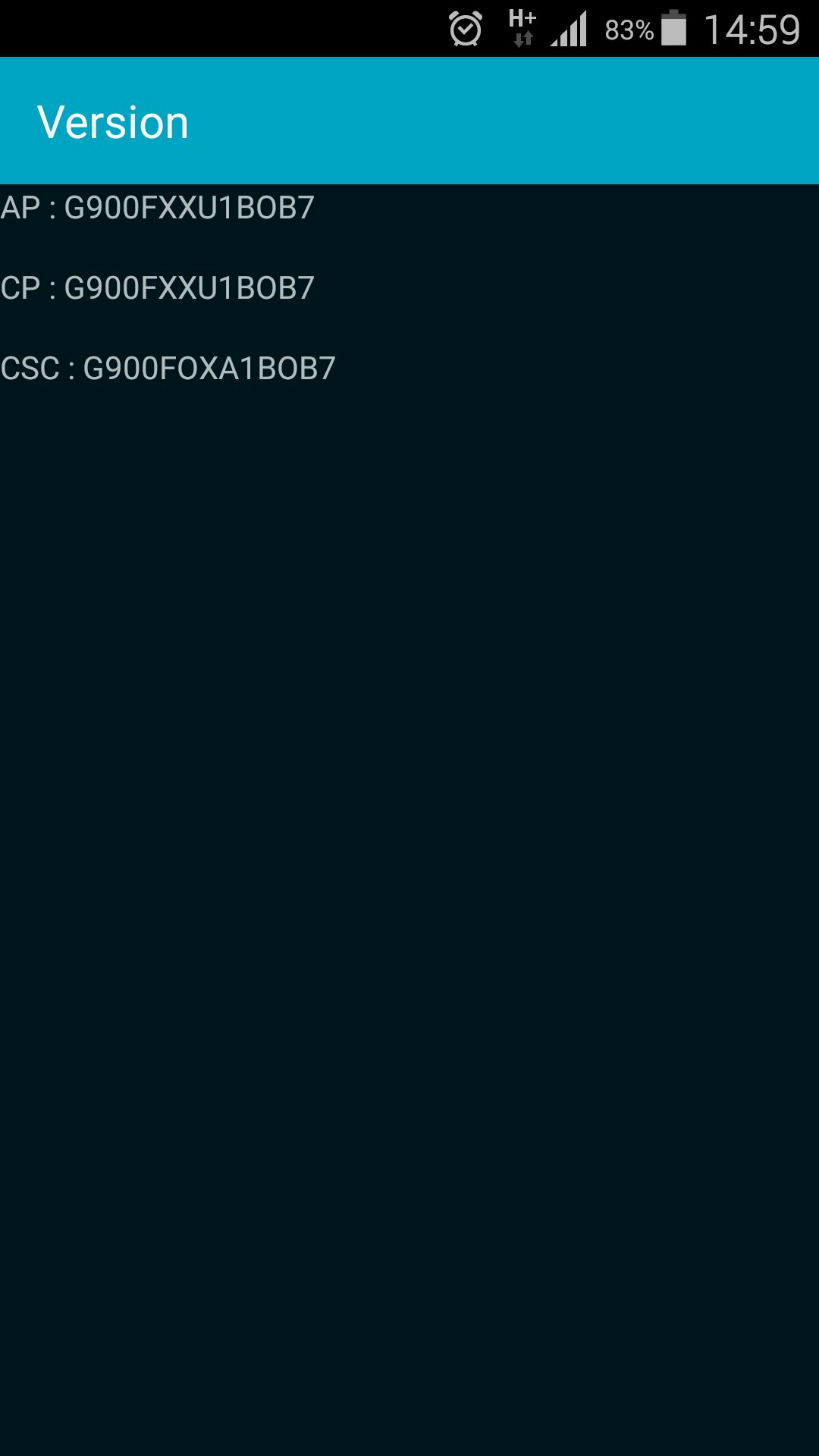

That's exactly the firmware that I am currently on! :)
IMHO, it is by far the best Lollipop release so far. Apart from the Mute toggle and screen pinning, Samsung have obviously done some work under the hood, so to speak. I am finding this latest release very fast and smooth with no lags at all. Particularly so since it does not come with any carrier bloatware whatsoever.
App constantly crashing, freezing etc just generally laggy
Am I right in thinking that your phone came with O2 firmware, originally, and that you had an abortive attempt at rooting it a few days ago and flashed the generic firmware for the UK, yesterday?
Yes I bought the phone second hand already unlocked
OK. The problem with a second hand/pre owned phone is that you do not know what has gone on with it before in terms of rooting, flashing, water damage or even repairs. Therefore, it is always a good idea to do a Full Wipe of both the phone, its internal and external storage, (as per #2.3 & #2.4 of the S5 Lollipop Update Problems - Dummies Guide), to ensure a clean start. You should Factory Data Reset the phone and then download and flash, via Odin, the stock Samsung firmware for your model. Then, as per #2.5 of the aforementioned guide, prior to loading any user apps or settings, check the phone's operation out thoroughly to see if you are experiencing any of the issues that you were previously. If you are, then there could be a problem with the handset itself. If not, then redownload your apps but not the settings. Far better to re-do your settings afresh. The same applies to your storage. Check that all apps and games are Lollipop compatible... some are not inspite of 9 months warning to app developers. Keep checking your phone as you go, to see if at any stage your issues return. This will help you find the problem.
