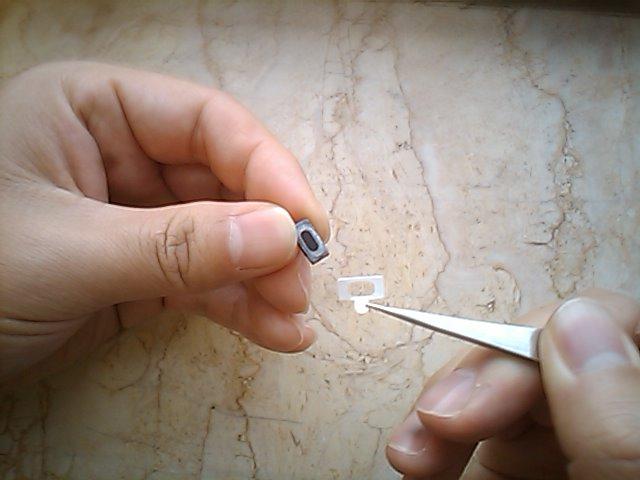

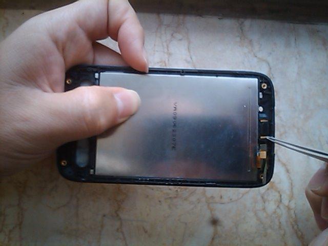

1.open the phone
2.to take out the A part of receiver
3.to tear open the paper of the receiver,to place the new receiver.ps:to turn upward the sheetmetal
BOM:22030029
receiver-32ohm-5*10*2.65
Size:5mm*10mm*2.65mm + 32ohm
