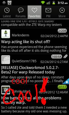

screenshot is upsidedown
If you buy the paid one,there's an option to flip the image so you get the pic right....BTW I'm talking about screenshotit
See?
See?
I went and bought the application just because of your post. Thanks. Check out the one i did right off.
