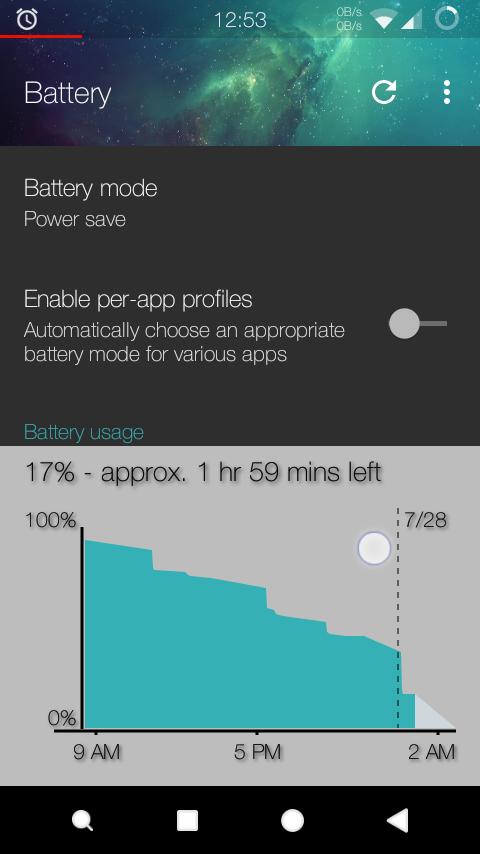

Okay, so the battery indicator works well enough, that you won't suddenly find yourself thinking you have more battery life than you actually do?
Actually that is much of the case. It works, then it doesn't. My phones been on the charger for like 2 hours untouched and it still says 32%. It refreshes after a reboot, but then it may or may not show the battery drainage and it has shut off unexpectedly. Its hit or miss, but like @Bichofelix said it works to enough of a degree that I don't care.
It'll get fixed and that's enough incentive for me
Upvote 0
Charging doesn't work. Draining is accurate as long as you use powersave. It will update every so often. After charge simply reboot to recovery, power off from there, then power on again. That's about it.
Eh, I've used this thing since the day it was built. Worlds better than stock rom. I even reflashed stock to check and it's just so god**** laggy.
