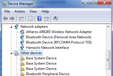

GOTO DEVICE MANGER IN YOUR PC'S CONTROL PANEL
YOU WILL FIND APX IN OTHER DEVICES THEN
RIGHT CLICK AND UPDATE DEVICE DRIVERS
SELECT THE USB PC DRIVER FOLDER UNDER CHINESE FOLDER AND ALLOW IT TO BE INSTALLED
SORRY NO APX IN MINE AS DRIVERS ARE ALREADY INSTALLED
