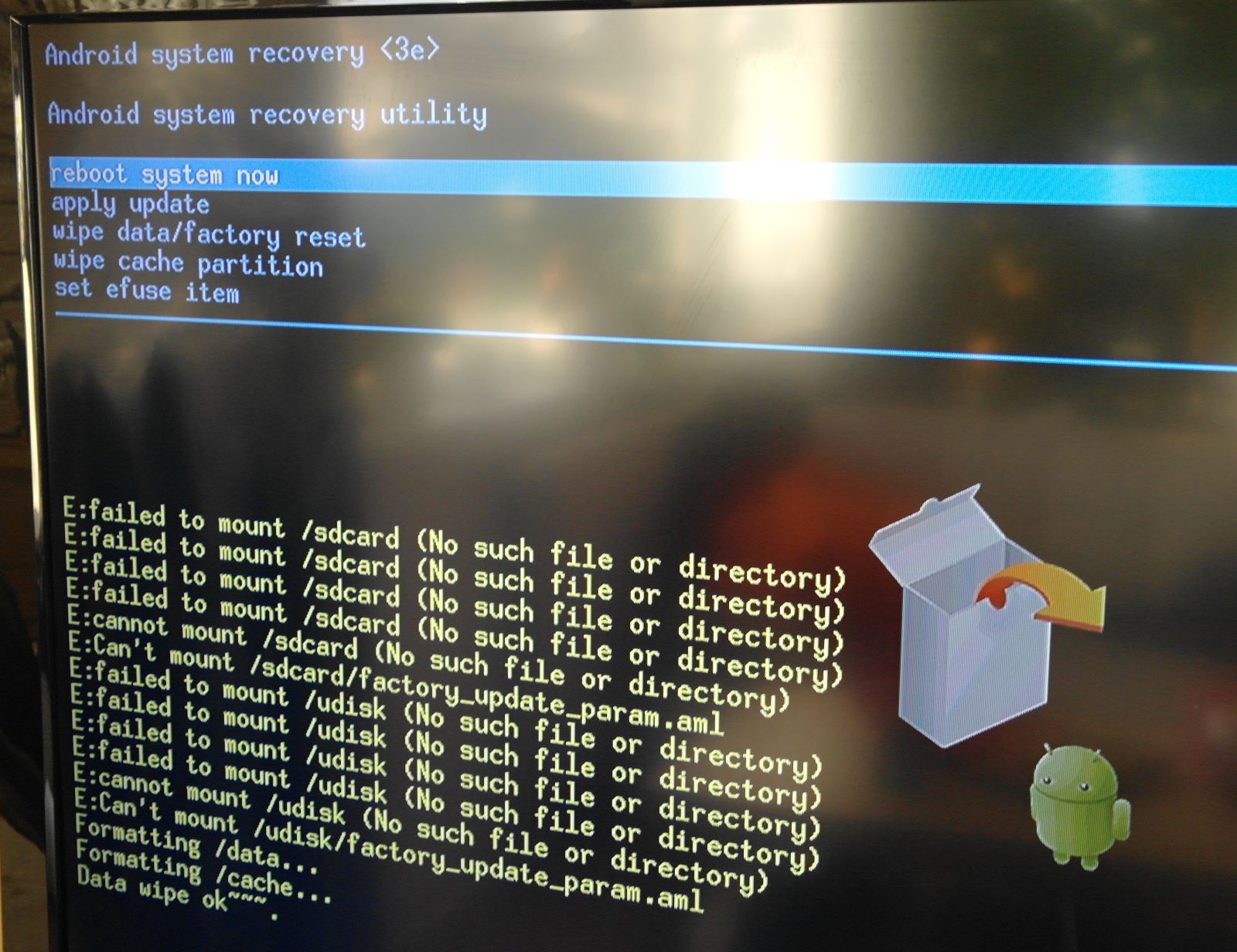

Hello again!
Now still stuck in Recovery Mode where the Device cant find my SDCARD and UDISK.
I attached some Photos from my Box and the Recovery Screen.
Is there a chance to update the Firmware from PC via USB ??
I see no other Chance to restore via SDCARD.
And NO, i can not select Apply update or anything other, because Keyboard and Mouse are not recognized at this time.

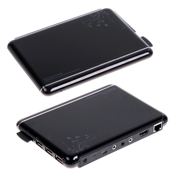

Okay, so I have a similar, but much more generic version of this, my box has no manufacturer's name on it or anything, just a few specs...
according to my box it's an Amlogic box, running the following specs:
1GHZ Cortex A9 AML8726-M CPU
DDRII 512MB RAM, 2GB-32GB Flash
Android 2.3 operating system
Wi-Fi, Ethernet
Full HD 1080P Hardware video decoder
HDMI/VGA/R/L(AUDIO)+CVBS/SPDIF
Support wireless keyboard
SD card slot, up to 32 GB
USB interface, support high capacity mobile hard disk
online video, music and games
support video conference
can connect USB camera
Because I'm a new user I cannot hyperlink but below is a link to the device I have:
www,sunsky-online,com/view/237098,htm
Now the device shown is the same, but mine is white, and if the apps shown in the picture are pre-installed, then mine is missing those as well.
The bolded apps are the only ones that I actually have:
Google Market, Gfan Market, Weather, RSS News & Calendar, IE, IM, Mailbox, Video / Audio player, Picture viewer, Text reader & Games, On-line Video/Audio player
The other apps that are included are AppInstaller, Browser, Calculator, Camera, Clock, Downloads, Email, FileBrowser, Flash Player(not sure what version), Mk_bkplay (don't even know what this is), Network (could not figure out how to work this one, just says "scanning" forever), PPPoE (haven't played with this one, just ethernet settings), Search, Settings (of course), Upgrade, Websites (bookmarks), and some Chinese labeled app that I don't know how to read or translate.. nor do I care too... No offense to any Chinese people on this forum...
Now what I need to find is an upgrade that actually allows me to use the remote control and is slightly more stable than the one above. I have two units, one I upgraded, the other I left stock. I also would like to know how to get the firmware back to stock if I need to... Please help.
