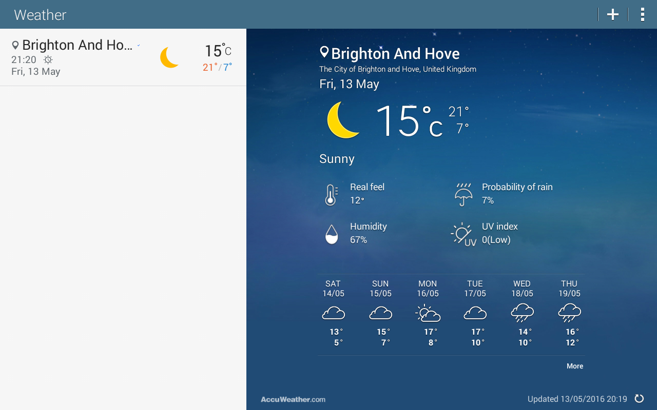

Still struggling with this ridiculous but annoying problem.... When I click on it I go through to this screen and if I take the location for the weather bit off, the clock goes back to normal. It's not daylight saving as if anything surely it would be an hour behind...any other ideas?
Try going into your phone's Settings >> Application manager and tap on the Accuweather app. Tap the 'Force stop' button, then tap the 'Clear data' button. Now restart the app from your Apps menu and reconfigure it from scratch, hopefully that will match up the widget and phone time.
Per the above, there are two clocks, the main clock is working well because it automatically adjust daylight/standard time. The secondary clock is from that widget/app and that widget/app is inferior because it does not adjust for daylight/standard time automatically. So you need to go that app/widget as some have mentioned above, to adjust the clock to the actual time. This problem will reoccur every March/November when the time changes and you need to make that adjustment.
