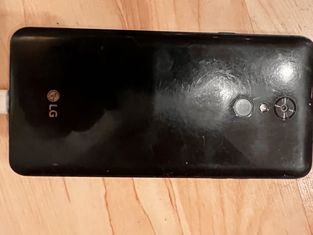

The LG phone is "LG Stylo 4"

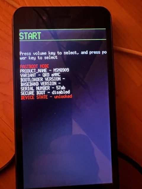

The other is Ultimate MobileX powered by Android Go; device unlocked, no secure boot.

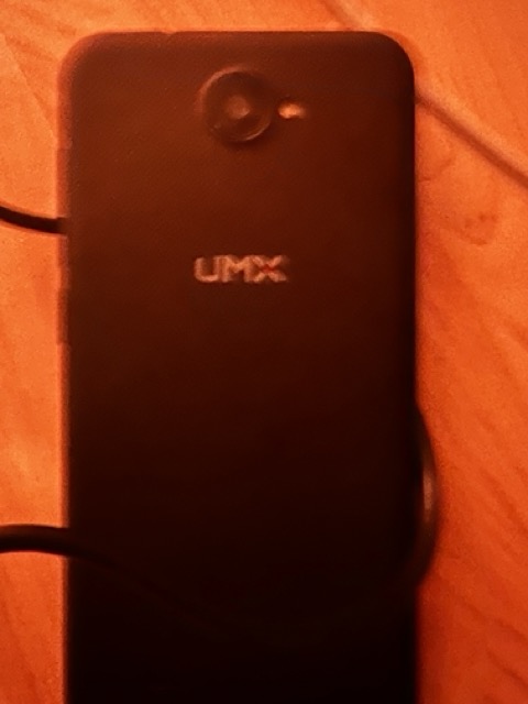

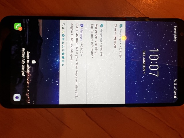

A lot of it is going to be determined by what version of Android these phones were running. Maybe if you post pictures of the phones we can identify them.

Okay. Thanks for the details ... it helps us, but not you. The LG Stylo is from 2018 and shipped with Android 8.1 so it's encrypted by default. I doubt your "tech moron" friend decrypted it since that's quite involved. Access from a file level perspective would be fruitless.
The other phone is actually a UNIMAX U683CL from either Sprint or Assurance. This Ships with Android 9, so same problem. Rooting isn't your answer, if it were possible.
Do you have any idea which gmail account she used to register each of these devices? It could also be that your friend was backing up to these accounts without knowing it. If you setup the gmail accounts, go to a PC and log into each one and see if there's any files saved there. If you're looking to retrieve texts or email, these are saved in system databases and are not accessible independently. They have to be recovered through the phone if they weren't backed up off the device.
Here's what I would try. Turn off the phones. Log into the gmail accounts on a PC. If you don't know the password, perform a password recovery. If there's no alternate recovery email, and only the mobile number, then you'll have to put her sim in a working phone to get the text from Google to verify the number. Once the account is logged into, put in a data enabled SIM card in the locked phones (WiFi won't be much help if you can't log in and connect) and boot the phone. Give it time to sync. It could be up to 24 hours. This is important ... DO NOT try to log in yet. After 24 hours, reboot the phone and try to login using whatever method she set ... pass/pin/pattern until it prompts you for the gmail account password.
That's the only practical way I can think of to retrieve the information from the phones.
