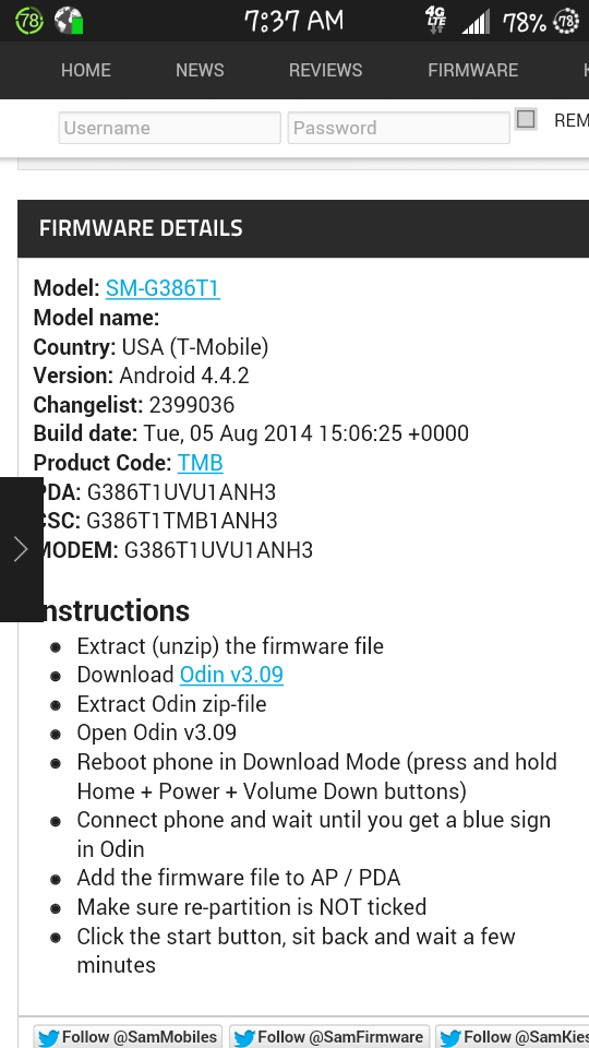

Hello, please forgive me if someone else has asked this or if it has already been answered, but I have the Metro PCS variant of the Avant and I was just wondering if I can flash this to my device? I know that it's probably the same as the T-Mobile version but the only reason I ask is because my device model # is SM-G#86T1 and I noticed the T-Mobile Avant is model # SM-G#86T. Thanks for your help!

Yes you can. Both phones are identical. I have the metro version too.

ok thank you, now would i just download the T-Mobile firmware and just flash using odin? Also, have you tried flashing the T-Mobile firmware on the M-PCS version and if so is anything affected (talk, text, data) anything like that?

Flashing the T-Mobile firmware doesn't cause any issues. I ran the T-Mobile firmware for almost a month. It just has a few different apps (T-Mobile instead of MetroPCS) and different startup & shutdown sounds & animations. Also flashing the T-Mobile firmware allows you to get T-Mobile service without paying to sim-unlock but it still works on metro too.
