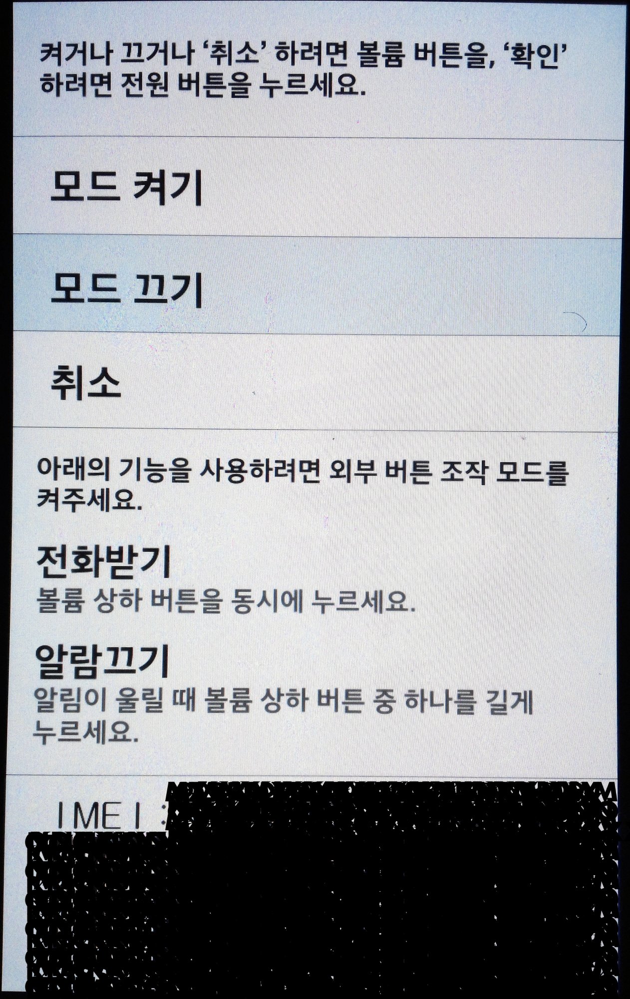

I get this now. Suddenly I boot into this. Tried translating services like Google no soap It's a .jpg & every time I convert it has Asian characters but it is not even close to the original. Anybody know what this means? The options are selectable so I have to know.

But the 2nd to last time I turned it on with pwr & vol up at same time. Got the above Korean screen. Disgusted I turn off by a button combo I forget. Might have been all 3 or vol dwn & pwr. I set my LG G Flex aside for 12-24hrs. Then I plugged into data cable into pc, booted to LG screen. Then instead of the Korean? screen or the TWRP logo then home. It booted into the AT&T screen with the jingle then my Android home screen. After a few few seconds it powered down with a polite ~not enough power to turn on message.
