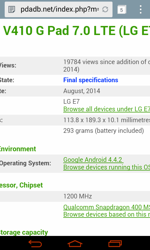

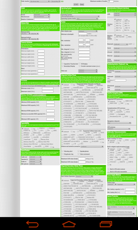

I'm gonna need some more details. First, when you say the TWRP.zip for the recovery image file do you mean the one from here (scroll down to "install TWRP Recovery......")? Because I had already flashed a stock recovery image before this happened. So which image should I put, the TWRP custom or the stock? I also don't have a directory for adb and fastboot. I have installed on my PC an application called "Minimal ADB and Fastboot", but I don't know if that is what you mean. Anyway the application is installed in program files (x86). Do you mean that directory? And lastly, when you say to type FASTBOOT RECOVERY FLASH RECOVrY.IMG, does the image has to be renamed as "recovery.img"?
Look here http://pdadb.net/index.php?m=specs&id=6491&c=lg_v410_g_pad_7.0_lte_lg_e7 then where it says chipset
Tap on the "browse devices..." (look at photo)
Itll pull up ~40 devices matching chipset.
(Not for the feint of heart)
Or you can do an advanced search and narrow it down even more by using this link http://pdadb.net/index.php?m=pdamaster&posted=1&cpu=a8926#form
