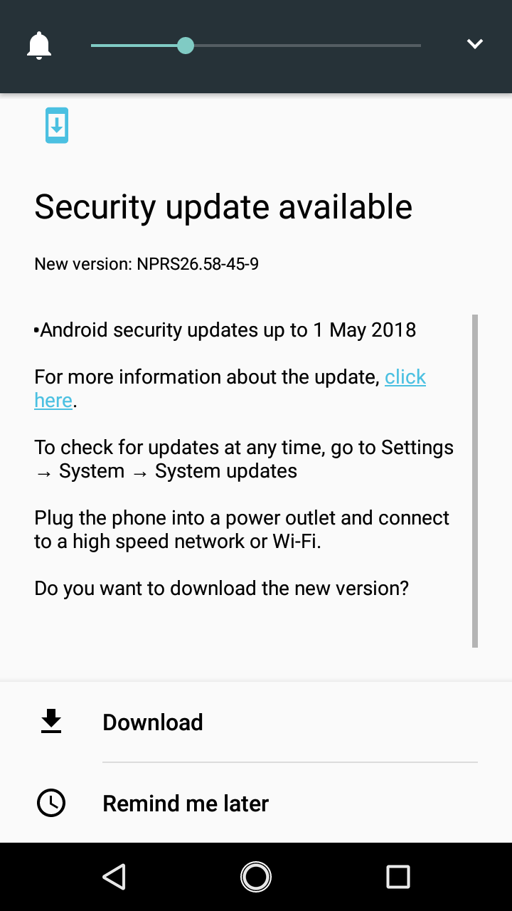

should I or will it screw it up?
Stock updates:
Don't do it if you have twrp, need stock recovery.
Don't do it if you have Root.
Only do it if you are 100% stock.
Anyway to kill the notification?
There used to be, on much older devices but I'm truly unsure if it'll work on these newer ones.. You could do a Completely Back to Stock process using the Moto FW (Firmware) which will also install stock recovery and all stock updates will be safe.. Actually, I'd recommend that. That way you can do all the updates to the newest one, TWRP & Root your phone (if you wish), make a backup and go from there.. It may take a half hr or so to complete everything but you'll be on the newest updates, no sweat
Surprisingly I was able to kill the notification through notification settings
The actual update.zip is likely sitting in your /cache waiting for you to make the mistake of applying it. Assuming you're rooted, open the /cache and look. If it's there, delete (or safer yet rename it from .zip to something else until sure).
Unsure about Nougat, but on my MXP running MM there's an app named "Motorola Update Services" that you can "Freeze" with Titanium Backup to prevent any future updating from Motorola. Actual package (on mine) is /system/priv-app/3c_ota.apk. See if that exists, and if so you can simply rename that if you don't have the Pro version of TiB.
