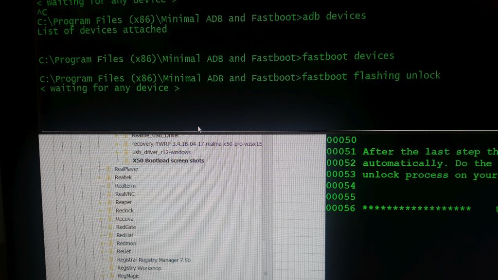

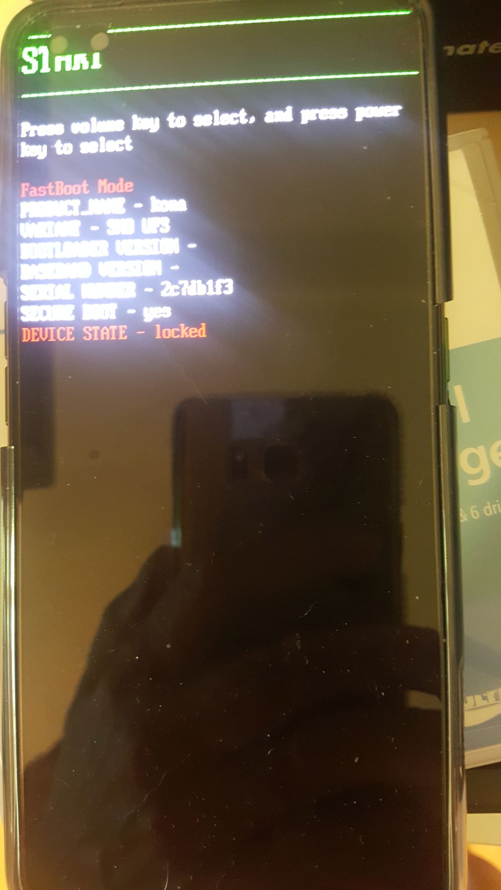

Hi,

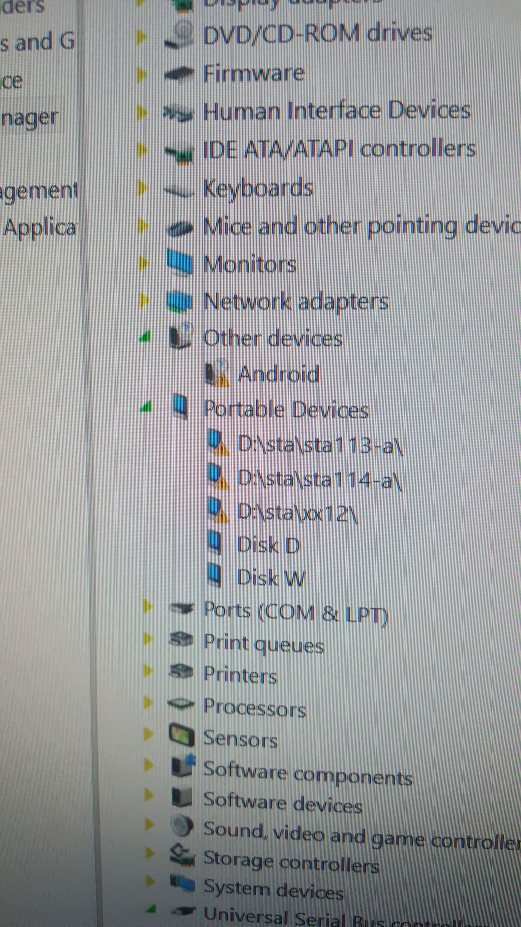

After I run the In-depth Test, and I'm at the stage when I see that the bootloader is locked, when I plug the X50 Pro 5G into a Windows 10 USB port, the device manager shows an "android" generic device, while it shows a "X50 Pro" when the phone is in normal mode.
The adb and fastboot commands can see the X50 in normal mode, but not when it is in In-depth Test mode, all I get is "waiting for any device".
I tried to update the driver of the "android device" with "Realme_USB_Driver" or "latest_usb_driver_windows_2", but Windows answers that the best driver is already installed.
So, I'm stuck, unable to perform a "fastboot flashing unlock" command.
I have enabled the developer options, and OEM and USB debugging.
What am I missing?
Thanks.

First, thanks for trying to help. That's vey much appreciated.
I tried a different cable, the one used to fast charge. I also tried a different USB 3 port.
Here are the screen shots.

First, thanks for trying to help. That's very much appreciated.

I solved the problem!
I ad to install the drivers from this Japanese file:
QcomMtk_Driver_Setup_V2.0.1.1.exe
from here:
https://www.hardreset.info/download/oppo-qualcomm-cpu-drivers/
and update the "android device with it"
That allowed fastbot to connect.
