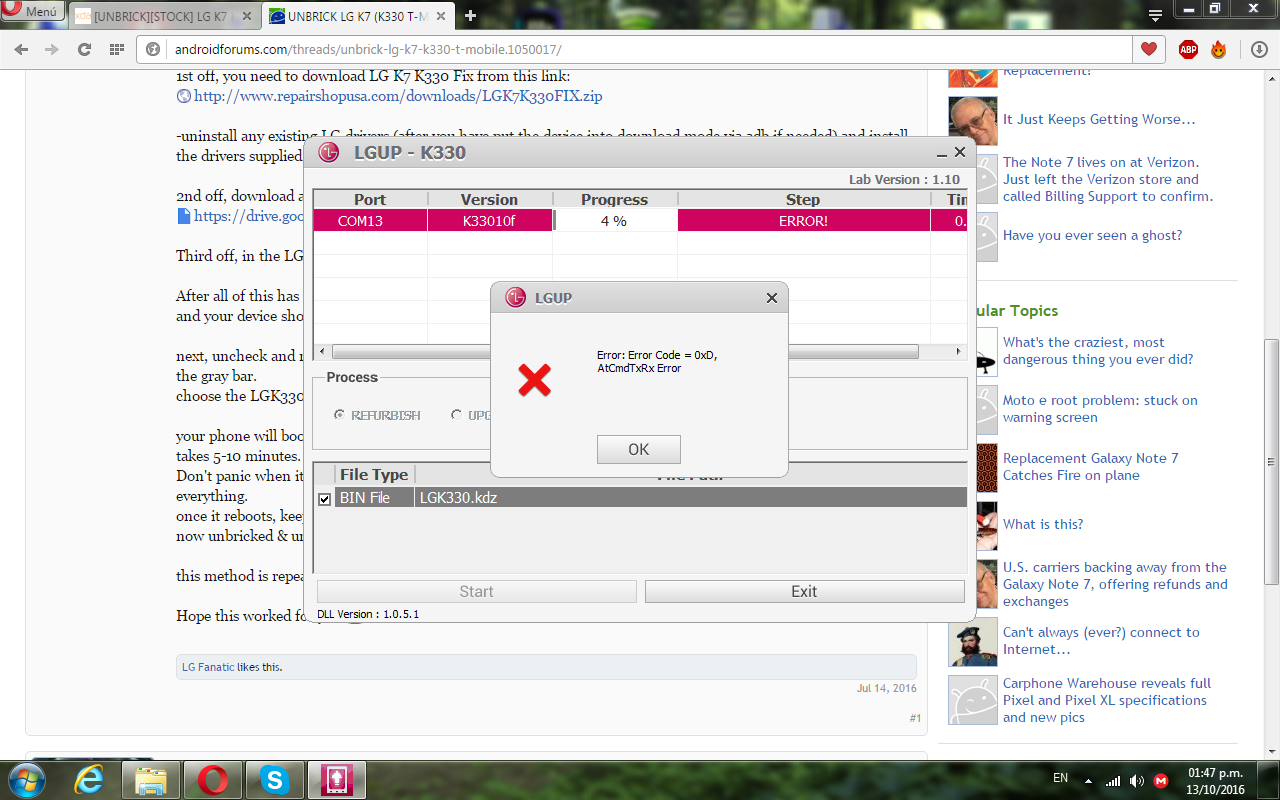

i have follow this tutorial step by step, but i bump in to the following error when flashing firmware start.

i have follow this tutorial step by step, but i bump in to the following error when flashing firmware start.View attachment 110829
Ah jeez, I'm sorry I didn't get to you faster. I actually broke the internal screen on my LG K7 and haven't been on the forums in a bit. I'm not sure why this is happening, try running the program in a different compatibility mode or if you haven't already, use it as an admin. I did this on Windows 10 so it could also be that, not too sure.
