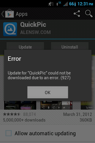

Okay, so I had already tried Uninstalling/Re-installing and clearing the Market and Google Framework caches... But I never thought of fixing permissions :p So, after doing that, re-installing the playstore, and clearing caches, my force-closing issue is solved, but a new problem arose... Now when I update an app, I get "failed due to an error (927)." When I download a new app (I tried Droidwall because it's free), I get something like "Your order is processing, please wait and try again." Waiting doesn't make it go away of course.

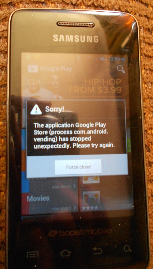

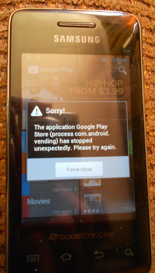

EDIT: Trying to download Droidwall again made this happen:
And now I can no longer start the Playstore without it force-closing. I think I'll try Odining back to stock a little later today...
