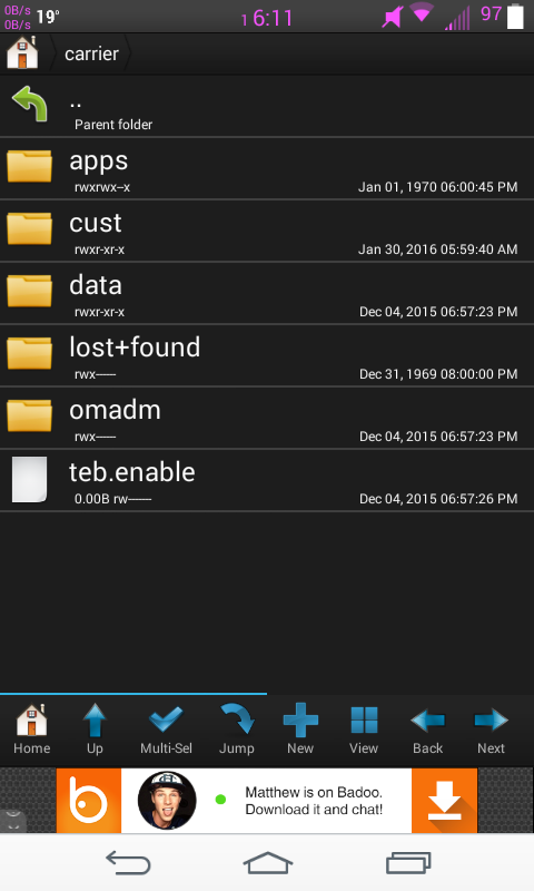

None of my roms include any of the sprint\virgin crap, my barebones rom is just a os. Sounds like your phone is screwed up. i have 4 people local that run my roms with no problems
If you deleted the itson folder under carrier you wouldn't have any problems with my rom. But if you flash anyone's elses rom it will flash all of virgin Mobile stuff back
