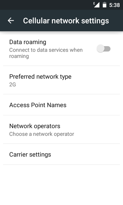

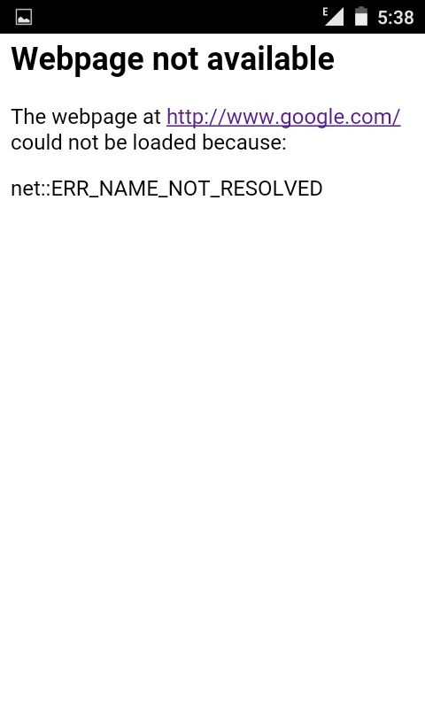

(d320n)
For me, data doesn't work. (but it shows network type, E for edge, for example) It's giving me some proxy errors when I try to load pages (not shown in screenshot, couldn't catch them). APN's are correctly set. Wifi works fine. There's no 2g/3g switch in quick panel, but manual switching works just fine. Also, in cellular network settings, there's an option "carrier settings". When I click on it, it disconnects me from network and I must reboot to reconnect. Home button still doesn't work, btw.
Here are some screenshots.
