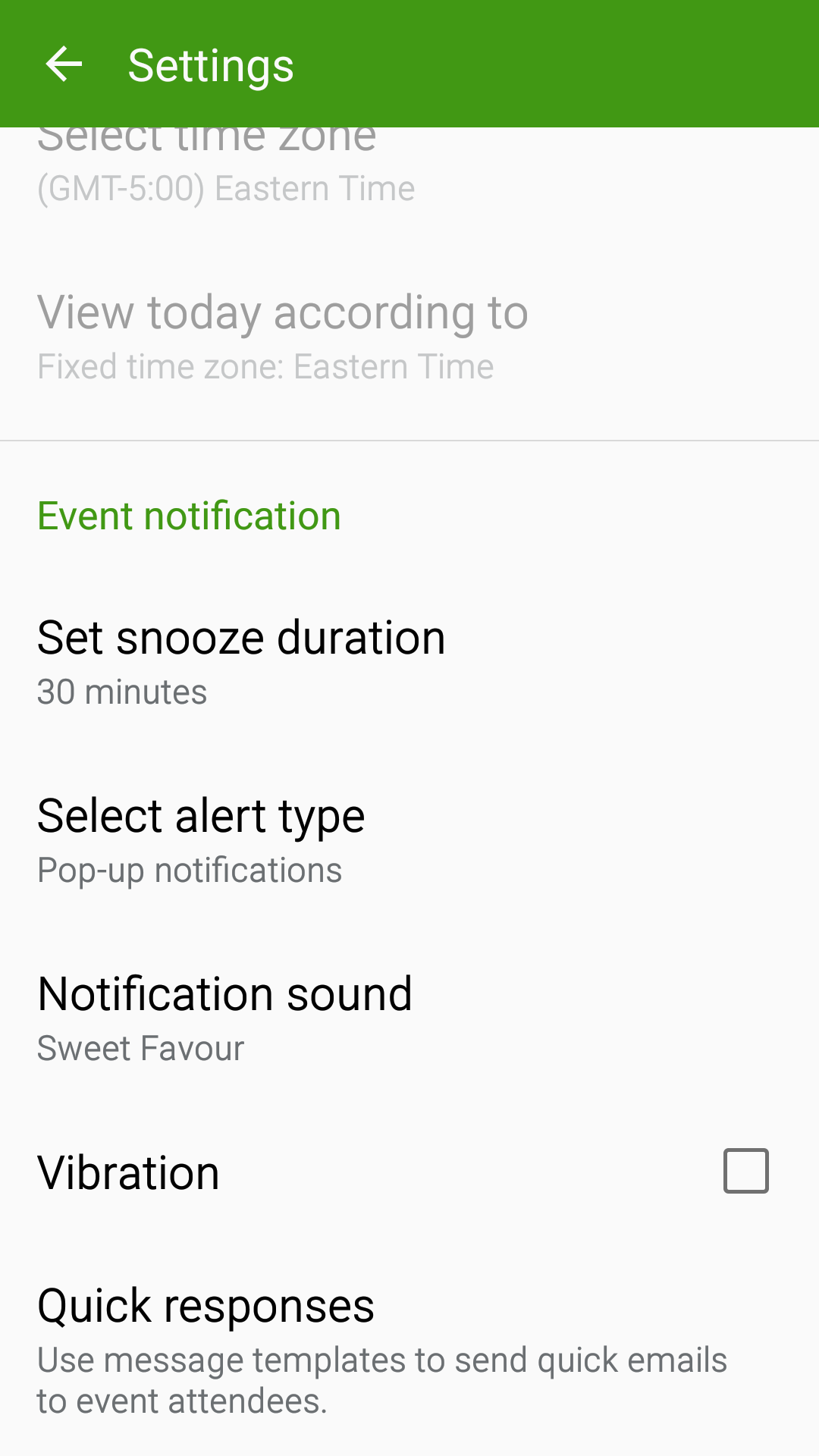

My choices are 'My Calendar' and 'Samsung Calendar'. Not sure how to tell which one I'm using. Also, here's a screenshot of the notifications menu. Doesn't do much.

When you get a notification that you think is one you didn't set, pull down the notification bar and long-press the notification. It will tell you which app sent it.
