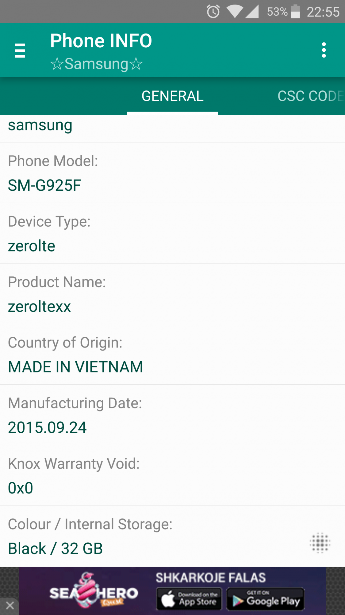

One last recommendation:
Load this app on your device,to ensure what you have is a genuine Samsung phone:
https://play.google.com/store/apps/details?id=org.vndnguyen.phoneinfo&hl=en
I'm aware that you took some OTA system updates previously,but,just covering all possibilities,in the event you have a counterfeit & somehow,ended up getting updates prior to the latest issues you're having.
If nothing else,this is an excellent resource,the app gives all kinds of information regarding your device. :thumbsupdroid:

A
Well,there's some good news,appears you have the real deal. :thumbsupdroid:
That factory reset is looking like your only option at this point,unless you wanna wait & see if others have suggestions............

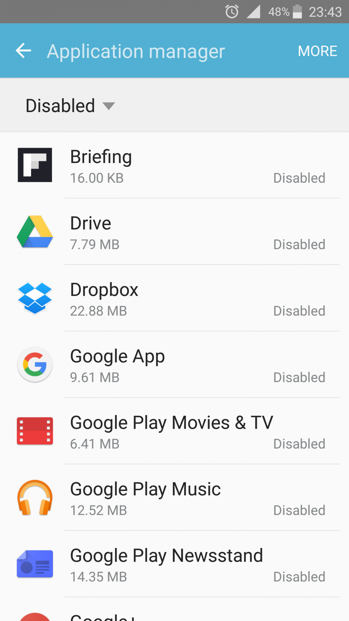

Bingo!
There you go. Many system apps share services so if you disable one you may remove functionality from the other. I would NEVER disable the Google apps if you want updates.
Turn them back on, reboot your phone and I'll bet your problem goes away.
Bingo!
+1
AAMOF, the app PACKAGE DISABLER PRO also specifically states to re-enable everything that the phone shipped with prior to taking updates:
https://play.google.com/store/apps/details?id=com.ospolice.packagedisablerpro&hl=en
Notes:
* If you have issues uninstalling apps, try Settings –> Security –> Device administrators, uncheck "package disabler admin".
* Be aware that in order to update your version of Android, you might need all original apps in place. It is advised to always have a backup of disabled packages so you can restore them later.
