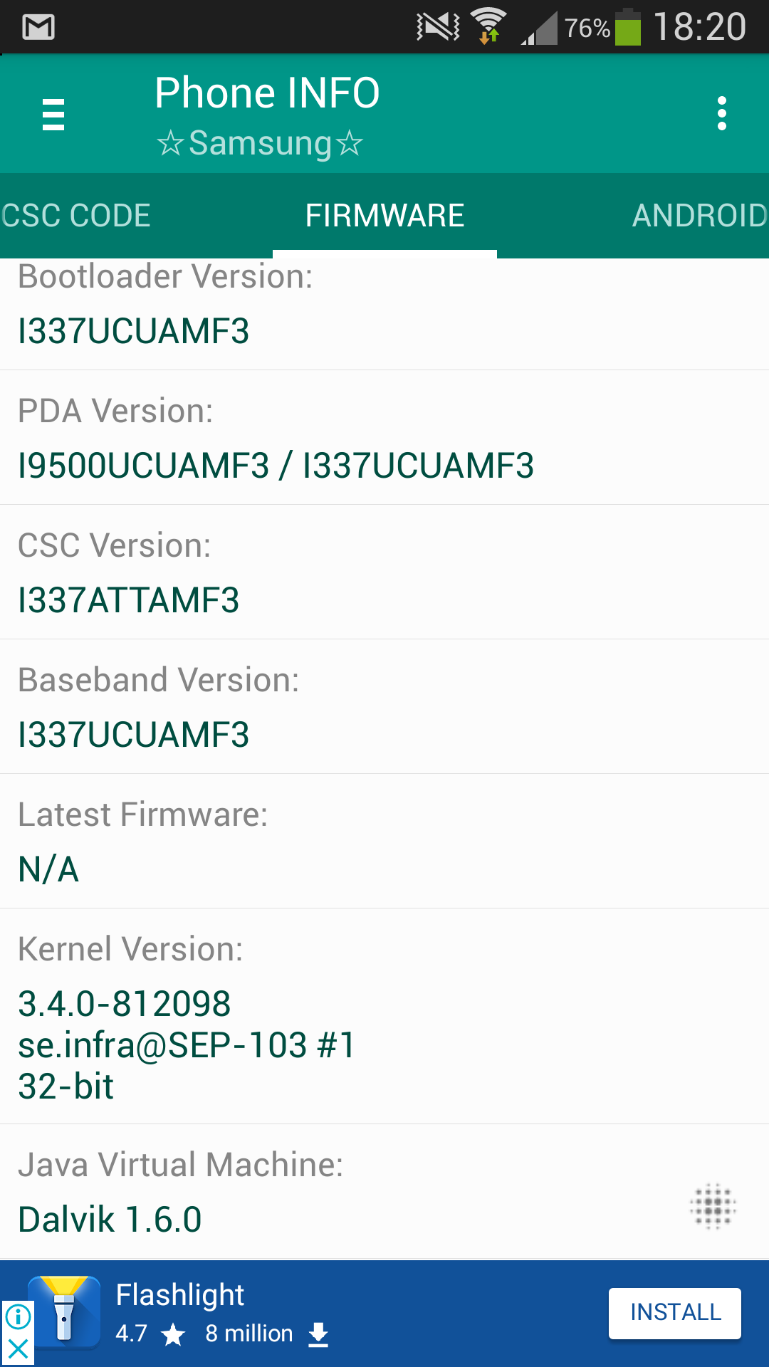

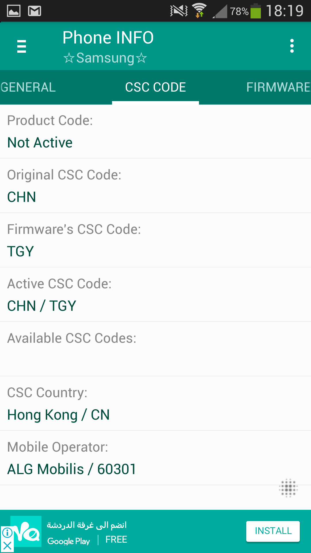

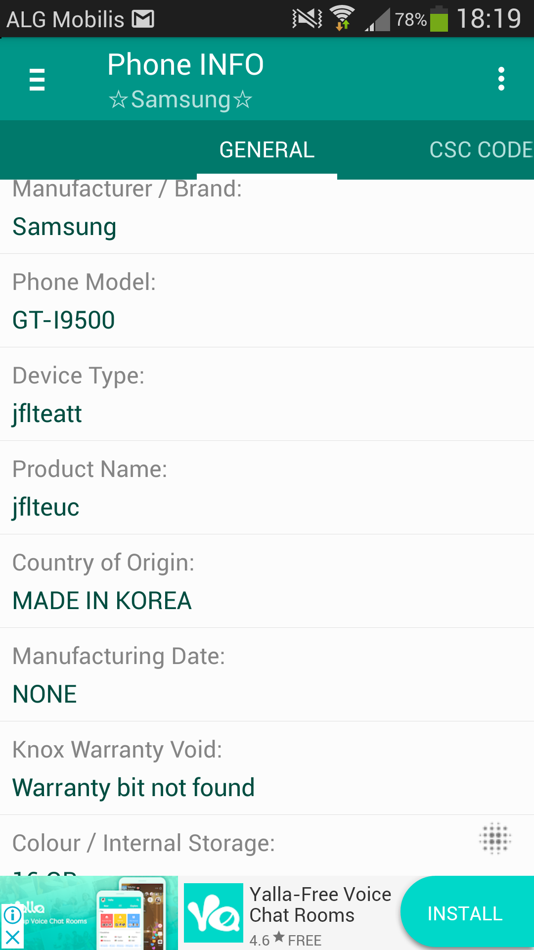

This
Could also be that you have a modified I337 AT&T S4 that the build prop has been modified to show I9500.
If this is the case, no firmware will work except for what you have on it now.
It would take someone smarter than me to tell you how to remove the modifications. Might want to take it to a local shop.
