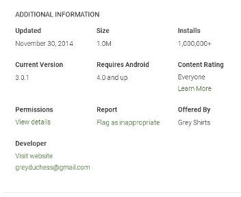

https://play.google.com/store/apps/details?id=app.greyshirts.firewall
Simply because it has a large legacy isn't a very positive indicator. Networking and the Internet have continued to devolve numerous, hazardous ways since then so relying on an out-of-date product to 'protect' you is something that needs to be addressed. I'll tentatively suggest switching to NetGuard or Mobiwol, two also non-root firewall apps that have active development and support.

I tried the firewalls you mentioned but they do not offer port/url level control.
Noroots firewall OK it's old but does offer & successfully implement port/url level bans. Just like on the good old pc.
