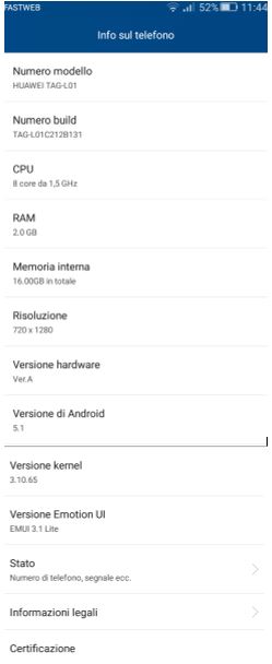

as written, mobile is P8 Lite - TAG-L01 - Android 5.1 - EMUI 3.1 Lite, that's a branded italian operator phone (Tim mobile), see screenshot.

p8 lite info
