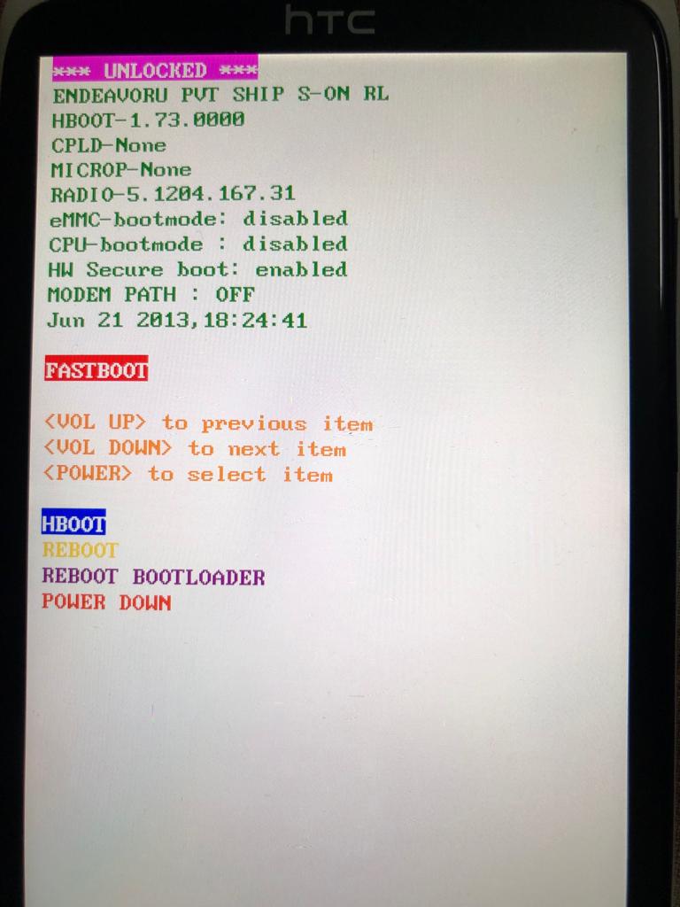

Thank you for writing me back. I was on a vacation myself. Now I am ready to ruin my already ruined phone again. First of all my phone says unlocked on the top of bootloader. Secondly, I have got ENDEAVORU PVT with hBOOT 1.73.0000 (no idea what this is) along with RADIO 5.1204.167.31. I looked for this version for hours but I couldn't find it on your given websites. Can you help me get the right RUU please?
p.s
I have got philz recovery 5 (version 6. something) for adding and removing stuff.
EndeavourU is just an internal HTC codename for this phone model. PVT can be ignored, and HBOOT-1.73 is just the bootloader version.
So, first question: as you have a custom recovery do you want to install a custom ROM rather than returning to stock software?
If you want to return to stock you'll have to relock the bootloader (you can't flash an RUU while unlocked if you are S-On, and S-Off would be a complication too far at this point). Then we'll need to know your cid (which you can obtain using "fastboot getvar all"), or else what region & carrier (if any) the phone was originally sold in/by (unlocking, rooting, none of that makes any difference to the cid).
However, I can't guarantee that we'll find an RUU for that phone. The software is later than that of most people who were having trouble finding RUUs a few years back, so I'll not be totally surprised if none of the available RUUs work. If not then it's either back to the custom ROM or try to download and restore a nandroid backup of a stock ROM. There is an XDA thread on that here, but a couple of caveats: I've never used Philz recovery, so don't know whether it's compatible with TWRP or CWM backups. And while an RUU won't let you install the wrong software for the phone (as long as you are S-On) a custom recovery will, so best to make sure of the CID first and choose the newest one for that model. Also some of those are quite old software versions (even by One X standards), and I don't know whether one of the really old ones would work with the newer firmware on your phone. Finally I've not tested any of the links so don't know whether any of them still work. (Is that enough caveats?).
Alright so I did the getvar all and this is what I got:
(bootloader) version: 0.5a
(bootloader) version-bootloader: 1.73.0000
(bootloader) version-baseband: 5.1204.167.31
(bootloader) version-cpld: None
(bootloader) version-microp: None
(bootloader) version-main: 4.20.415.4
(bootloader) serialno:
(bootloader) imei:
(bootloader) product: endeavoru
(bootloader) platform: HBOOT-T30S
(bootloader) modelid: PJ4610000
(bootloader) cidnum: HTC__J15
(bootloader) battery-status: good
(bootloader) battery-voltage: 3829mV
(bootloader) devpower: 57
(bootloader) partition-layout: None
(bootloader) security: on
(bootloader) build-mode: SHIP
(bootloader) boot-mode: FASTBOOT
(bootloader) commitno-bootloader: None
(bootloader) hbootpreupdate: 2
(bootloader) gencheckpt: 0
all: Done!
finished. total time: 0.830s
Hmm, HTC__J15 is ARA (Middle East & Africa), and the only ARA RUUs I've found in places I know are much older than your software.
