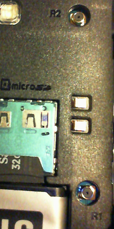

heres a bigger picture of my phone, I had to make it smaller for another forum that wouldnt allow big pictures ,apparently this forum does allow this size of photo.

There's a good chance that R1 is your Wireless a/b/g antenna and R2 is your N if you have that technology on your phone.
If not then there's a chance that your phone is using a MIMO (Multiple In Multiple Out) system to give less interference to your signals when xmitting, and receiving. If that is the case then it'll be REALLY helpful to get two antenna. But don't do that until you figure that out :P

Okay iv finally got some time and patience to try and piece this together .
so far you are the most knowledgeable about this stuff and I appreciate the feedback as it will help me narrow this down.
From my understanding there are a couple options here. I either buy a pigtail adapter that has one cord and goes directly to either R1 or R2 and the other end goes to my external antenna. Option 2 would be having two cords going to both R1 and R2, which I believe you were mentioning in your above quote. One other person wrote a similar message, but he wasnt too certain. this is the product he has suggested.
NEW TYCO INTERNAL LAPTOP NOTEBOOK WiFi WIRELESS ANTENNA
NEW TYCO INTERNAL LAPTOP NOTEBOOK WiFi WIRELESS ANTENNA | eBay
With this option I do not understand how too cords can be used. I will be using one external antenna so how can I hook 2 pigtail adapters up to one external antenna, im very confused lol. I actually called samsung today, i finally tracked down someone who could offer more advice other than " dont open your phone and leave it alone!". The person told me that R1 and R2 are infact used for attaching antennas for cell phone networks to improve signal strength. And i said okay well that sounds exactly like what im looking for, but im looking for improving Wifi, but its the same idea. Hook up pigtail to R1 and R2 and then external antenna. He agreed with me but he said samsung has not tested this and therefore cannot recommend me doing it... in other words they work with the big cell phone companies so they only endorse improving the network strength!
OH and I checked more about which type of wifi my galaxy note has and this website indicated that it does have N wifi technology. "Dual-band Wi-Fi 802.11 b, g and n support" So according to you the R2 should be for the N wifi.
Really im just hesitant to try this because I wouldnt want to wreck my phone somehow. I dont see how it could but this is the most expensive and nice phone iv ever had!! ;)
If those are the wireless network antenna ports then they're not going to work to improve wifi at all (possibly 4g, or 3g- but not wifi.)
This means that the antenna for the wifi on your phone is a flat style antenna and you'd have to find out where it's at, and do a direct solder mod inline with the current antenna which is 1. Dangerous if you're not a professional electronics specialist, and 2. Stupid because the boards on cell phones are EXTREMELY sensitive, and thin.
Looks like the best bet for you would be to just leave it alone.
