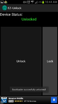

Use ez unlock from the play store.
hmmmmm i have that installed along with superuser. Ive tried it in unlocked and unknown and locked, all 3 tell me the same thing. Is there something other than clicking unlock that im supposed to do ? maybe this is a sign telling me to leave the phone alone lol

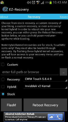

I downloaded ez-recovery and installed on external sd card

I unlocked bootloader VIA "ez-unlock"

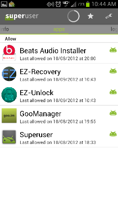

I thought I would try rooting by method #2 and I still get the same results
I would:
- Run the zip file through an MD5 checker in Windows to verify it is good; I use WinMD5
- Use TWRP 2.2 rather than CWM
Are you using the internal "external storage" or the external SD card? If the latter, use the internal SD card instead.
Finally, I've had nothing but problems with GooManager, so I don't recommend it (or at least, don't use it when you are having issues).

IIRC, CWM has difficulty with external SD cards; TWRP, however, does not.
Did flashing with TWRP give the same error?

I havent tried it yet, Im not too sure which TWRP to get for a Galaxy s3 on verizon. There are so many that come up in the search
Get EZ-Recovery from the Play store and install 2.2 from there (see the rooting/flashing sticky for links, info).
