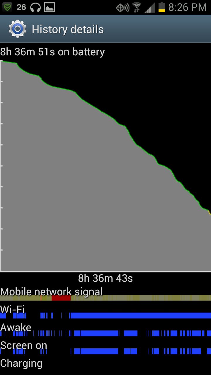

Check out the scree shot below. As you can see, I live in a fairly marginal area and spend time in a downright bad area. But while I was in that bad area, I was still able to make and receive calls with good clarity and post some stuff to fb. I have no idea why some of our phones are doing well and others suck. Is it defective phones or Verizon? Not sure, but I'm happy so far. We'll see if I remain so the next time I head up the coast.
