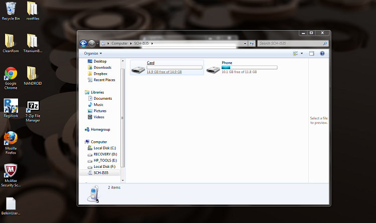

When I use my PC to view the files I have two options, one says Card, the other, Phone......... under phone, is where I found my TitaniumBU file. Does this mean I have been backing up to the internal storage? Does anyone know how to change that in TBU?

(Q)When I use my PC to view the files I have two options, one says Card, the other, Phone......... under phone, is where I found my TitaniumBU file. Does this mean I have been backing up to the internal storage? Does anyone know how to change that in TBU?
(A)Not sure on that. However, once booted into Twrp, you can choose to save backups to external storage, with the option to name your backups. Possibly to change the destination save folder in titaniumBU, go through the settings in the app.

So, I bought a new card (Can never have too many right?)
Also, seen here in TBU no /storage/ extsd\
Never uploaded pics before, hope it works :):D
Keep hitting the back button while in that screen on the right until you are at:
/storage
Then scroll down the list until you see :
extSDcard underneath.
Select that...
let me see if I can post a better pic
Oooooooooooooooh ok got it!!! Thanks:D:D:D
