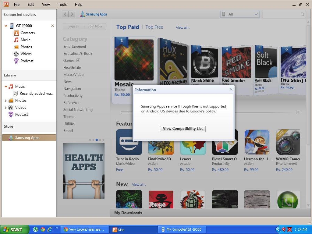

when i start samsung apps on my phone it gives error network unavailable
where i can open other sites and internet is also proper on the phone
even it installed samsun kies in my pc with the cd i got with phone but that was outdated version i downloaded latest version but through that also i am not able to download games or movies in my mob
please guide what to do

don't hijack someone else' threads, create your own
