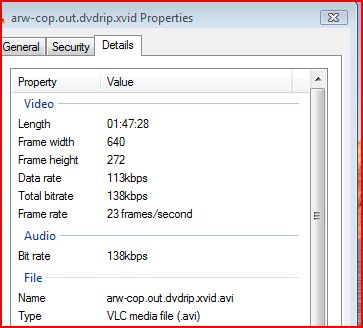

ive done the same (drop into SD card) what ive noticed is that if i forward to far ahead its all jacked up..if i just let it run its fine.
hers a pic of the info.. (i hope)
