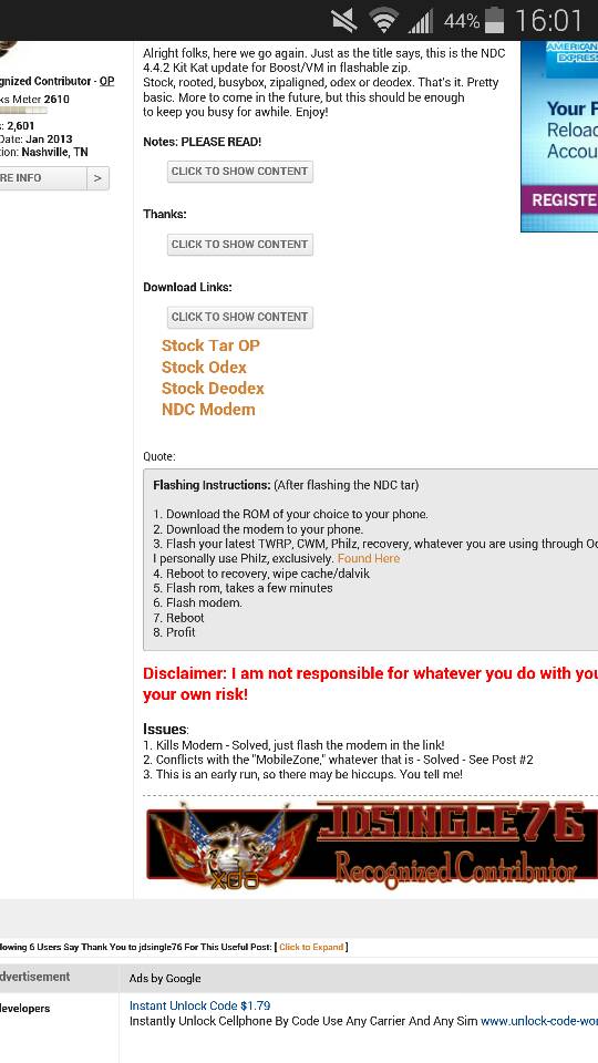

ive been looking all over for the tar version, cant find it for the life of me
Hmmm...If you click on the link in the OP, it takes you to the ROM op, it's the very first link under downloads.....
