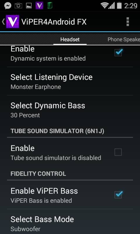

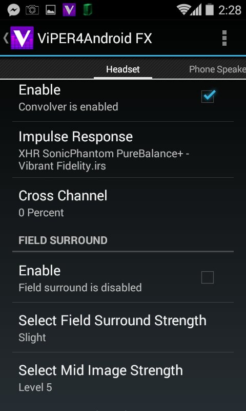

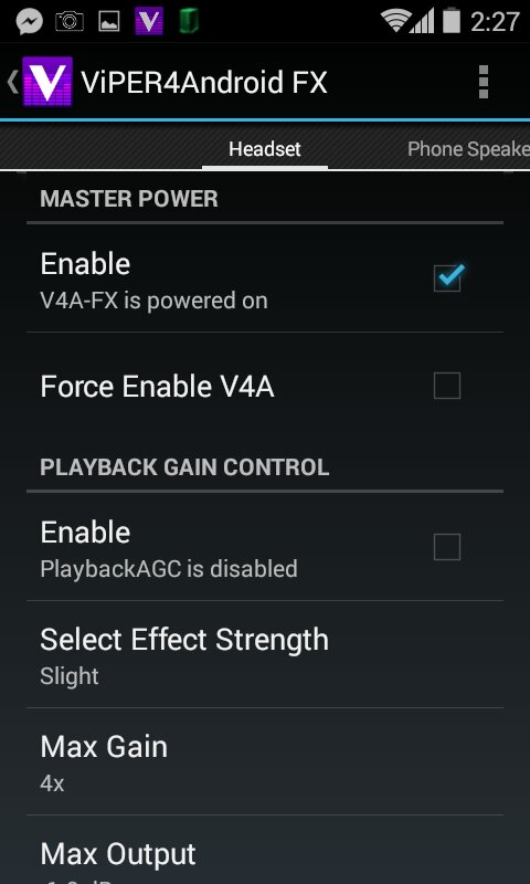

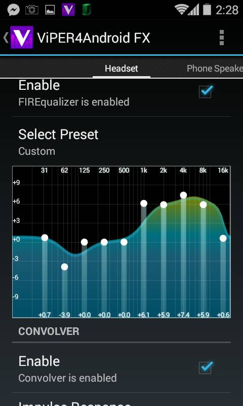

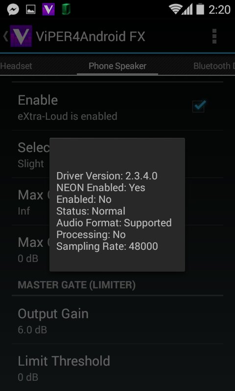

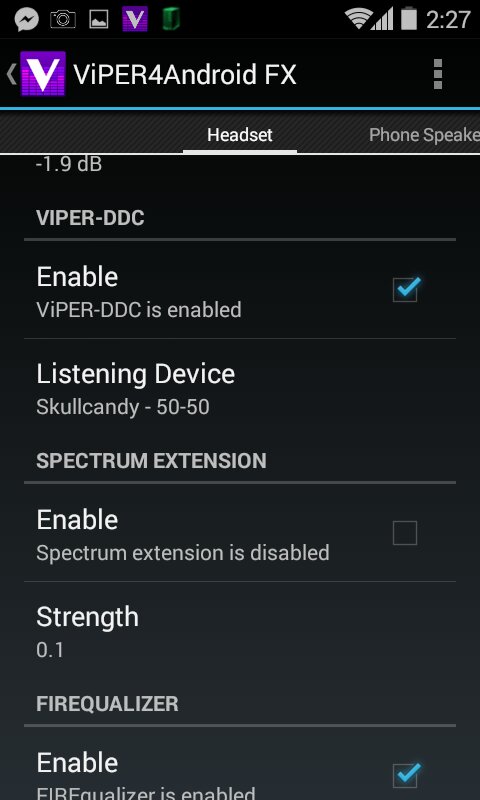

Also don't forget to change ui settings to expert then find output gain set is to +6 there will be your loudness change I will post screenshot of my setup when I can
This is what the driver status should look like

Might be out of order lol sorry but I got my stuff sounding straight like your at the concert
