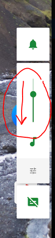

I have a Pixel 3, and recently the volume control is... out of control. It will randomly decrease in volume or mute. If I raise the volume back up, it will go back down on its own. Sometimes the only way to keep the volume audible is to hold down the volume button... and then sometimes even that won't work.
What's most frustrating is that this seems to happen mostly on my morning runs. I keep my phone in an arm band, so don't have ready access to fight with the volume control. It's really screwing up my workouts. :-(
Is this a known issue, and is there a workaround or solution?
