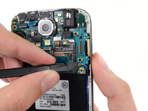

I don't know if replacing the antenna would be the fix, it's basically just a piece of inert wire. A more likely issue would be since the S4 model has been around a while, just through normal usage the antenna connector might have become loosened and just needs to be re-seated.
This link has step-by-step directions on how to access the antenna and connector (pic above is from step 13):
https://www.ifixit.com/Guide/Samsung+Galaxy+S4+Motherboard+Replacement/16537
Ignore the dis-assembly aspect of the article and just focus on opening up your S4 to get to that connector.
Re-flashing the firmware is a software thing, you'd be rewriting the factory ROM over the original one on your phone. It's essentially the same as re-installing the operating system on a computer.
I'd be leaning towards the antenna connector as your problem but a re-flash, especially on a dated phone, can often fix a lot of issues.
I'm inclined to open it up and try reseating the connector. The phone has been dropped more times than I'd care to admit and I wouldn't be surprised if everything is rattling around in there.
Try re-seating that connector and see if that restores your WiFi connectivity. Also, since you'll be opening up your S4 it's a good time to take a minute and re-tighten the screws holding down the motherboard to the inner frame.
(Bluetooth uses the same antenna. Have you noticed any issues with using Bluetooth? That would also be an indicator pointing to the antenna.)

Welp. I took the phone apart, only cracked the case a wee bit (!). I undid the connectors and reseated them carefully and firmly. No difference. Le sigh. I'm on Swappa shopping around for an S6 or an LG G4. I called a phone repair place yesterday. The guy was really nice and talked me through some possibilities. He said he suspects the chip is loose and oxidized. He said he could reflow it for $40 but thinks it will end up as a temporary fix. He doesn't really think I should bother. A new motherboard is $130, so that's totally not worth it. I guess I'll go drown my tightwad tears in milk and cookies.
;)Just in case you're interested, that WiFi radio chip is show here in step 13, outlined in black. Step 14 shows the Bluetooth chip in underneath that same Broadcom chip. Step 15 shows the opposite side of the motherboard itself.
