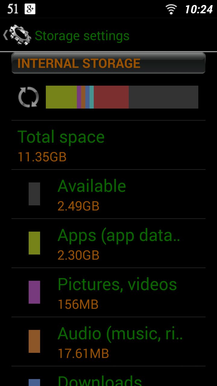

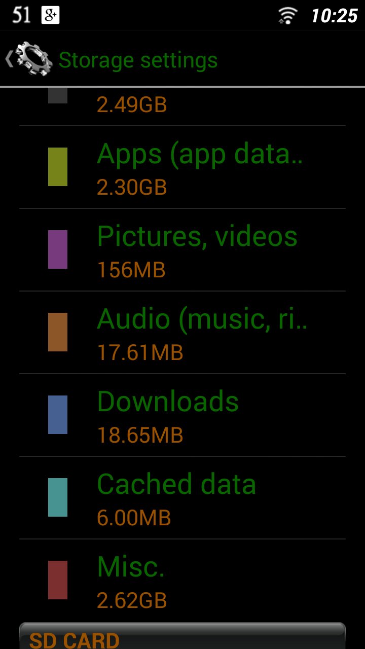

So i did a full factory reset (from settings menu) like a week ago because i was getting low memory messages.
Ended up with 7GB free internal memory after restoring my apps, great.
I havent installed any more apps or added many downloads to internal storage since and now look.... uploadfromtaptalk1385375308232.jpguploadfromtaptalk1385375329687.jpg
:confused::confused::confused:
I really dont understand android storage lol.
Ok ive been going between 4.4 and 4.3 but i thought the storage mess had ended by now? :beer:
One thing it might be is this. I noticed when going from 4.1.2 to 4.3 was in my sdcard memory it created a new folder called 'sdcard0' (think it was called that)
Maybe yours is the same and needs combining?!?!
Yeah know what u mean bro n thats what i thought id cleaned up with the format but since then ive only been using 4.3 and 4.4 roms n i thought they used the same structure or whatever? :beer:
as its never happened to me the only thing I can suggest is maybe hooking it up to a pc and going through ask your internal folders to see if anything's duplicated.
I'd also check any default folders for camera/video etc to see if it's changed
I havent installed any more apps or added many downloads to internal storage since and now look.... View attachment 64696View attachment 64697
Try this:
If you use Philz recovery there you can goto > mounts and Storage Menu > scroll down to "format section" and start going through the format cache, followed by /system, /data, /preload and finally /sdcard (which is your inter built-in card) - beware, it will blitz your device and nothing, except the content of your external SD-card will be left. You'll have a super clean device ready for installing any ROM you like. Then, you'll also have only one "0" partition/folder.
What recovery are you using for flashing stuff at the mo? I'd check you don't have a load of 0 folders repeated below the only one you should have I.e. data/media/0. Older recoveries can continuously create a new 0 folder every time you flash a ROM. Other thing to check is make sure you don't have a load of stuff that's somehow been put in data/media - or was left in there when you first jumped to 4.2 or later.

Ps i only have one /0 :)
