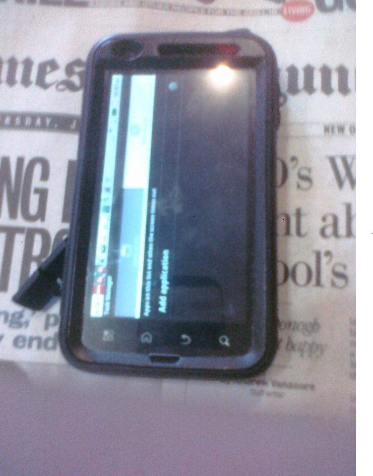

Atrix has an app killer as part of the base build. It is part of the task manager. They call is Auto End List. The a auto-end and states:
"Apps on this list end when the screen times out"
I've attached a picture
