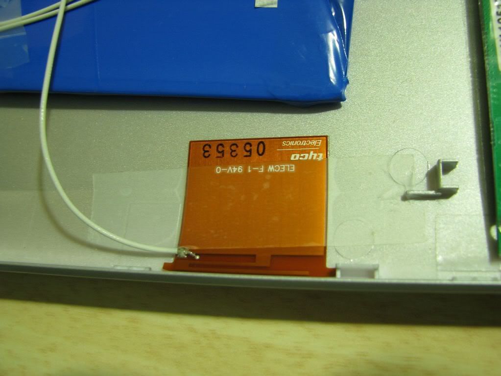

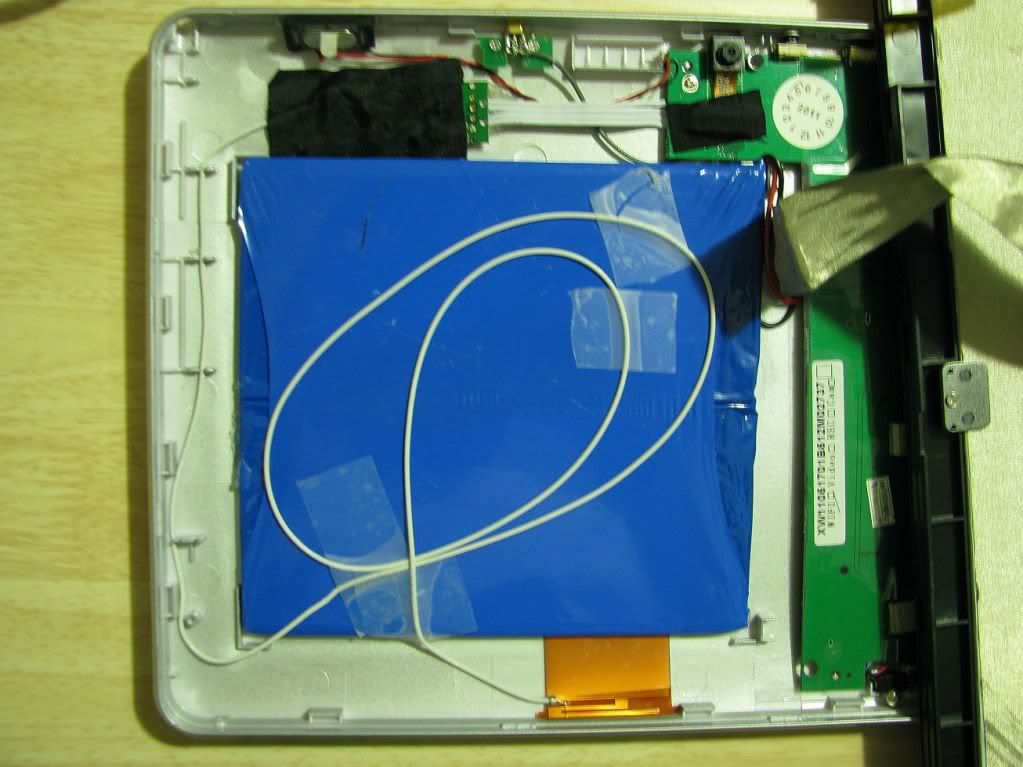

Over the last weekend I received the pair of cheap Tyco wireless antenna I had ordered and I went ahead with the mod for replacing the stock antenna of my FT3. I thought my attempt was a disaster since I ended up uprooting one of the components from the WiFi card while trying to clean the mess of glue from it. It probably was a capacitor or a resistor and it was impossible for me to solder it back. But to my surprise the card still functions. Lucky me!
Anyway the outcome of the new antenna was mixed since there was no discernible increase in the signal strength but now I find that the pad holds the WiFi connection up even if signal strength drops considerably. For instance earlier with the original antenna if I took the pad to a distance of about 20 feet with 3 dry walls in between the signal would drop to about -80 dBm and it would immediately drop the connection. Now with the new patch antenna the signal is around -79/-80 dBm but the connection stays up (albeit with a lower speed). However I am not sure now if this improvement is due to the new antenna or because of the missing component!
The patch antenna comes as a pair and I ended up using only one with the white wire which I noticed is used as the "Main" antenna while the other is used as "Aux" (in laptop WiFi cards). I couldn't find a suitable place on the WiFi card to solder the Aux antenna - perhaps it doesn't support it. BTW I also notice now that the WiFi chip doesn't get as hot as it used to - I haven't paid much attention to this so I could be wrong.
Here are some pictures I took while modding.
Picture showing the new antenna soldered in place of the stock one. Also shows the place where the component fell off.
Shows where I placed the antenna. I had to choose the lower part of the pad since there's no place on the upper part unless you move the WiFi card away. Upper part would probably be a better place.
Shows the completed mod with the battery overlapping the antenna. The wire is quite long and I just ended up running it around on the battery a couple of turns - probably not the best idea!
The last one shows the stock antenna.

Your soldering needs a bit of work, it looks like you might have wiggled the lead a little while the solder was still molten. Were you holding the cable?
Before I replaced all my fingerprints with burns and scar tissue I invested in one of those 'third hand' jobbies with little clamps to hold PCBs and other things in place. Mine has quite a large magnifying glass as well, it really helps...
Those 3rd hand things are a god send, I'll need to get one with a magnifying glass too, lol.
I would unsolder that and try again m8, no offence intended as I'm not exactly an expert myself. It looks to me like your wires might be touching due to the fact there's quite allot of solder there and like tbod mentioned you might have wiggled the wire while still molten causing the solder to meet.
That in itself could have an effect on your results with the antenna.
A few tips I've learnt through the years are-
(for the sake of this, wire= antenna wire solder=soldering wire)
1. Wait for the iron to heat up fully
2. Expose a little more wire than you need.
3. Heat up the wire your about to solder then melt a little solder onto it to give it a little coating and trim off the very tip of the wire to make it neat or the size you require.
4. Remember not to keep trying and trying if it doesn't solder straight away, you don't want to melt the pvc casing inside the wires (or the wires will touch) or damage other components on the board your soldering to. (or components will fall out, lol)
5. If you don't manage to solder it straight away, allow it to cool down then start again.
Like I say I'm no expert, I've made all the above mistakes myself and learnt from them so might as well pass on the info.

You need to loose about 2/3 of the feedline or you'll pay for it in losses!

Yes I had posted over on the other official forum but I find there's more activity here than there!
Thanks for all the tips deeboi.
Yes, I know I did a bad job on the soldering but its not as bad as it looks - at least there is no bridge between the center lead and the ground wire :)
@tbod, I was holding the wire and the WiFi card was dancing in the air so had a hard time getting to solder it! I was also thinking of buying a lens. Good advice on that 3rd hand with lens thingie - need to find out where I can get one of those!
@kb7urx, isn't it so that these lead lengths are intentionally long to match up with the wavelength of the signal? If not I can just the wire to required length to make it more neater.

In a perfect world, the feedline length should be no more than 1/4 wavelength long, minus the velocity factor...but we don't live in a perfect world. If we did, Velocity factor, Impedance, feedline losses and materials that go into making the feedline would'nt be an issue
Basically any random length of feedline will work but dealing with losses at output levels in the 10-20 mw range(usually expressed as dBm or Decibels per meter) doesn't leave us much to play with when you consider losses at -3dB, that's half your power lost!
Now lets consider your received signal. using 0dB as our point of reference, -80dB is a very miniscule signal, However since the Phase-modulated data is operating in Spread-Spectrum mode, the signal might be buried in the noise floor, but still useable....that's why you can get away with -70 to -80dB signal levels and still be connected and passing data.
Too much noise tho can swamp even the best engineered SS receiver front-end, causing multiple ACK retries or even complete packet losses! So, the caveat with respect to noise is too many cordless devices that operate at or close to the 2.4Ghz band can and do interfere with your WIFI including the biggest offender, your microwave oven that just happens to work at 2450Mhz...that's 2.45 Ghz...right in the middle of the GSM band, some putting out as much as 3-5 kilowatts for industrial versions.
So as you can see, you're fighting a battle of diminishing returns, just make the most of what you have or what technology offers.
And yes, reduce your feedline length to only what you need to get the WIFI adapter connected to the antenna and try to position the antenna as far as possible from any metallic objects, including the LiPo batteries!
