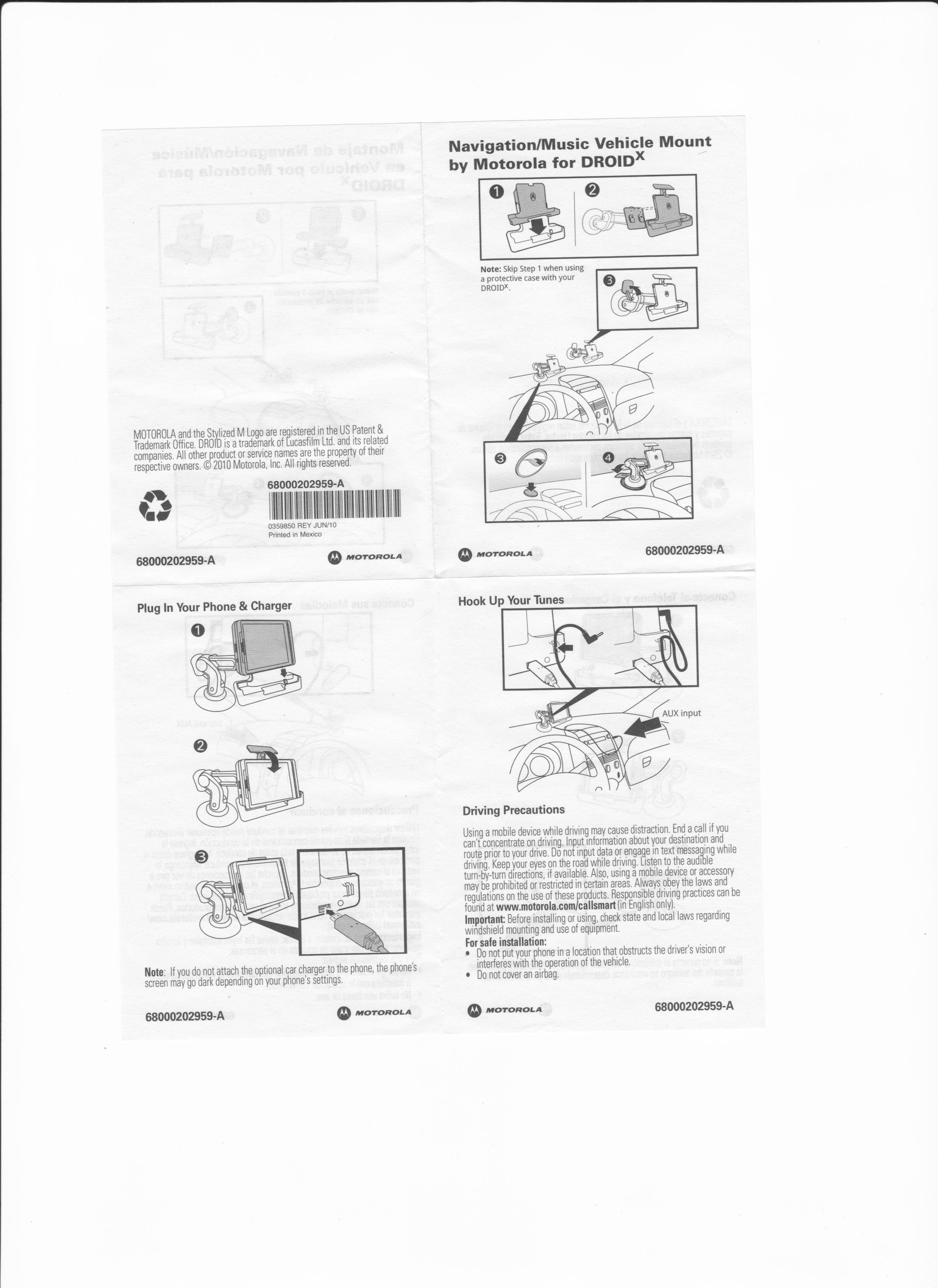

I just got my car dock / X yesterday. The car dock has a removable insert that is intended (according to the instructions) to be removed to allow you to use it with a case. Don't have a case yet, but plan on getting one, so I haven't tried this, but it appears that it will work with a case...
I got the car and home docks as well as the shell holster combo. Definitely will not work with the home dock. The car dock has a removable insert but with the same shell case on the X it will not securely mount into it. At first it appeared to be one of the two bumps on the back of the main part (not the insert). So, since it is not visible, I heated a utility knife and trimmed it (the larger one on the right). With the case on it will connect partially so it is recognized as being in the dock but is still not really secure enough to trust imho. When I looked closer, the case also makes a little too much contact with the front of the mount. Of course doing any trimming would make a good looking mount look like crap, so I am skipping that mod.
I just read through everything that came with the dock and I do not see anything about an insert. Can you post a pic?
Instruction sheet scan attached.
