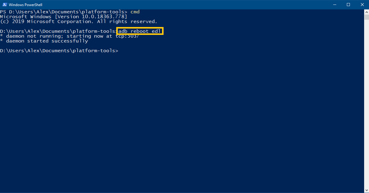

- Using ADB commands, type: adb reboot EDL
Open QFIL, You should see Qualcomm HS-USB QD-Loader 9008 (COM****)

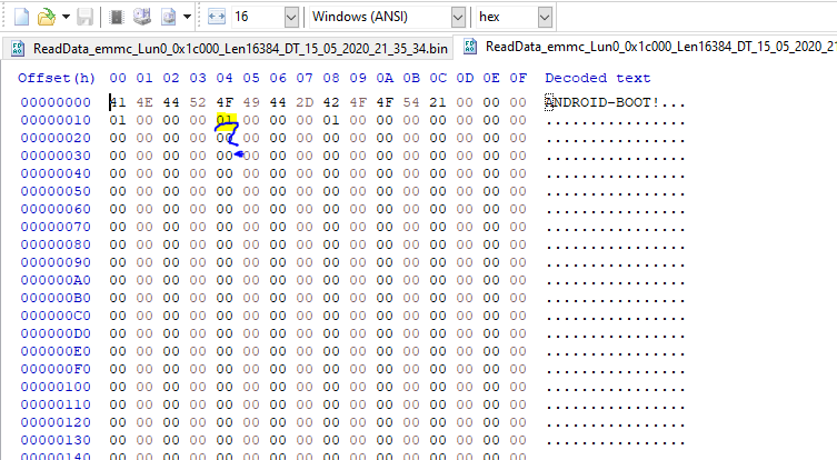

- Check the logs on the main window, it will show you where it will be saved (Most frequently in the Appdata/Roaming/Qualcomm folder) and the file will be named something like this: ReadData_emmc_Lun0_0x1c000_Len16384_DT_**_**_****_**_**_**.bin
- Copy the file we read to somewhere like the desktop and make a backup in case it does not work.
- Click File>Open and select the file we copied to the desktop

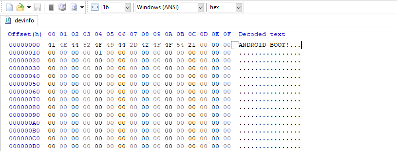

Edit this:
41 4E 44 52 4F 49 44 2D 42 4F 4F 54 21 00 00 00
00 00 00 00 00 00 00 00 00 00 00 00 00 00 00 00
to this:
01 00 00 00 00 00 00 00 01 00 00 00 00 00 00 00
- Go to offset 007FFE00 and repeat the same steps:
It looks like ZTE did put another ANDROID-BOOT! at this section, they thought I would not see the second one Make sure you edit that second one, otherwise the BL won't be unlocked.

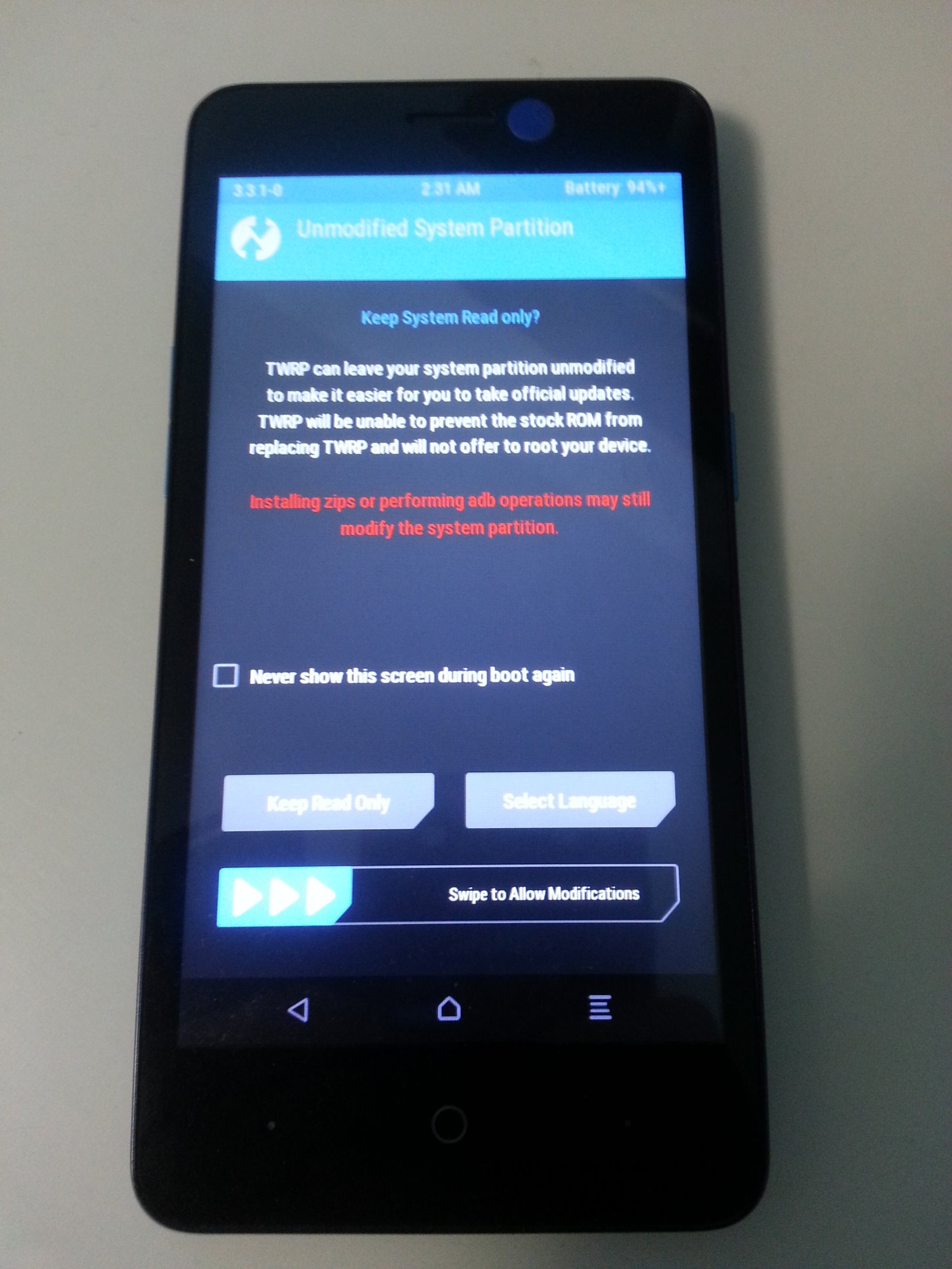

IT IS WORKING!!
TWRP is booting!
