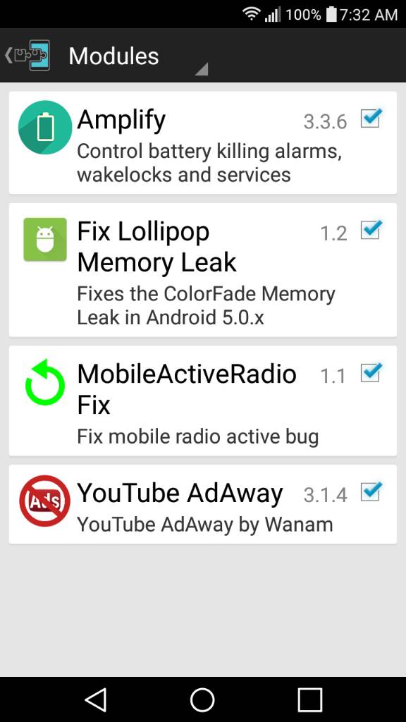

Here's what i have successfully Working on my stylo so far

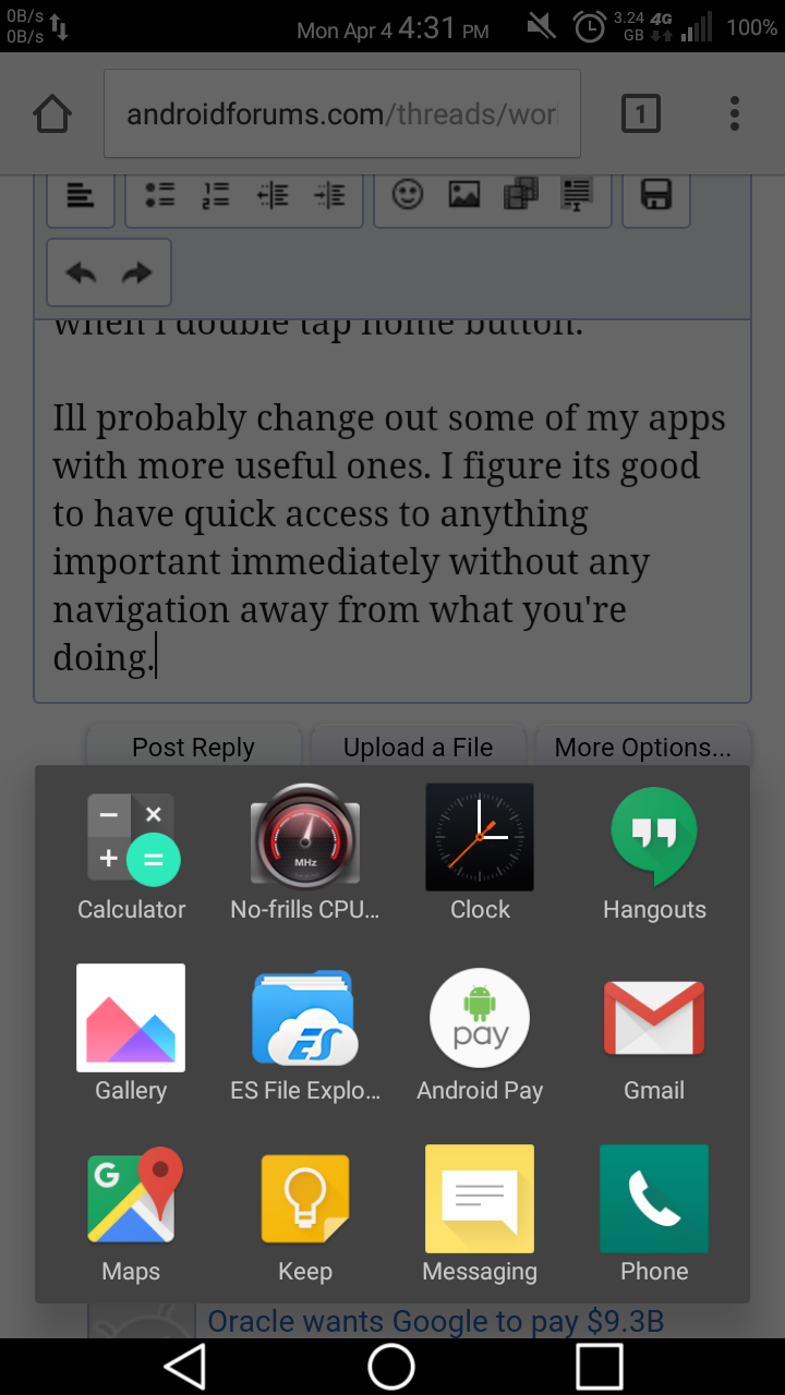

Some cool gravity box options for anyone interested....
I found one super useful setting that ive used pretty extensively. Android n-ify has the "double tap recents" to switch back and fourth from the current and previous app without the need to press recents and select the last app manually. Which is great.
Gravity box has this same concept and it can be applied to all software keys.
Now a double tap of my back button takes a screenshot. A long press records the screen (unfortunately theres a 3 min recording limit and there is zer sound) but can still be useful.
Long press of home still is google now on tap but a double tap opens a small compact app launcher (from any screen the home key is present/accessible (not on the lock screen sadly).
You can select up to 12 apps to to to there.
See the pic. Thats what it looks like when i double tap home button.
Ill probably change out some of my apps with more useful ones. I figure its good to have quick access to anything important immediately without any navigation away from what you're doing.

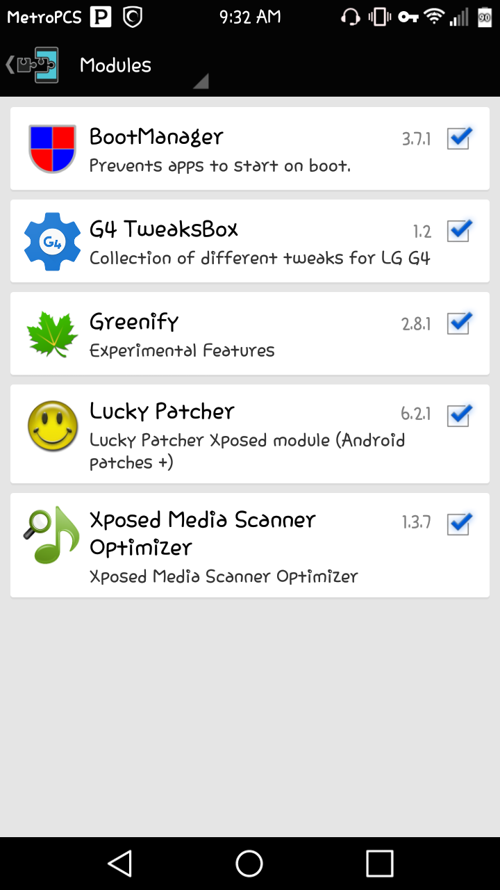

I have these installed. The ones with the NEW tag I haven't messed with yet. Xstana, Softkeyz and the Android theme engine apps im not 100%. All the other ones work for me with the exception of a few functions here and there inside Gravity Box and XBlast.
P.S. Im with Metro running the Tmo MM. Bootloader unlocked and all that stuff.

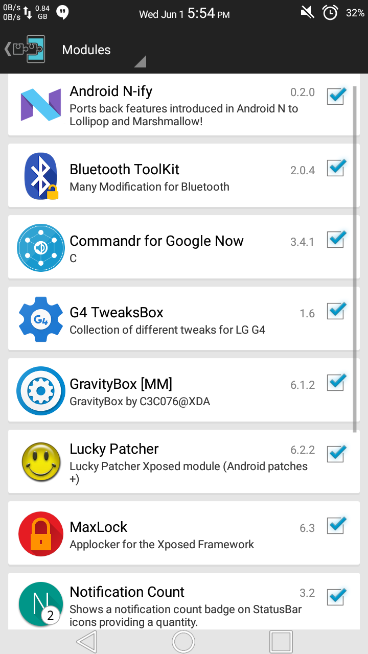

I have these installed currently. I may get rid of xnotifications. Its buggy sometimes
The new Nify update ruins the clock in the notification panel but ill keep it anyone hoping it gets fixed later

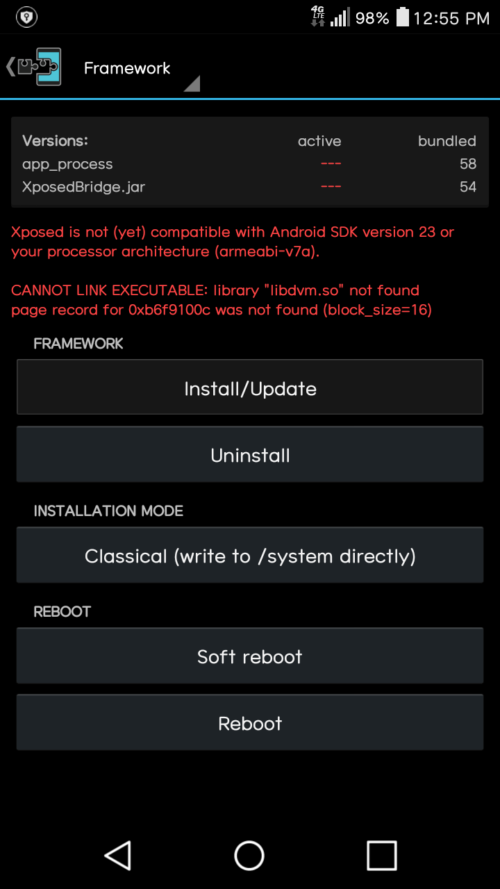

So I've never personally used Xposed (I don't know why, I've been rooting for years) and I get this error when trying to install the framework on my rooted, Metro Stylo running on the T-Mobile 6.0 update with unlocked bootloader. I'd really like to try some of these modules. Can someone tell me what I'm doing wrong? Thanks!
Worked like a charm, man! Thanks so much! The longest part was that it had to optimize 223 apps after reboot lol. Any tips, tricks or warnings with using Xposed on this phone?
Make backups before changing things just in case. I personally have never had anything happen due to an xposed module...just some slow startups. I don't speak for the other owners though.
