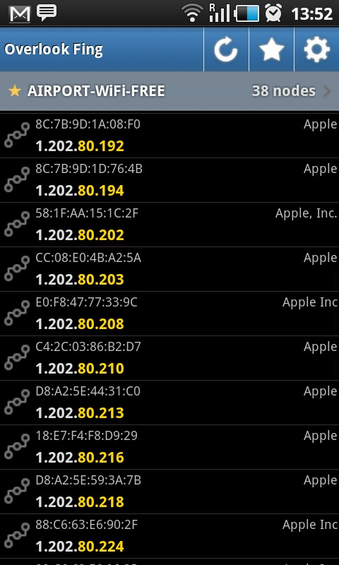

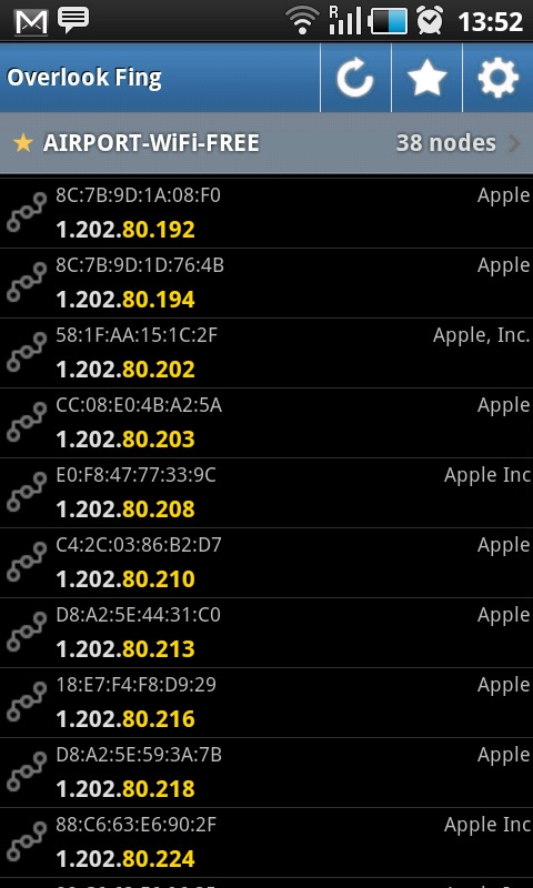

This is a screenshot of Overlook Fing being used at Beijing Airport. One can see that all the IDs are 'Apple' or 'Apple Inc', Probably most of them are iOS devices. Note that the only the first two have matching OUIs, the first 3 octets. I suspect Apple has many OUIs, and gets more as needed to avoid duplication of MAC addresses in its products. Going to be the same with many large producers of products which have MAC addresses, e.g. Cisco.
I think what actually happens though, as soon as a manufacturer has used up their allocation they can get another OUI(Organizationally Unique Identifier), which are the indeed first 3 octets of a MAC address.
And still ... I find it hard to belive that the near 17 million prefixes have been used up. I almost find it surpising that there isen't a way to register a new address like a domain.
