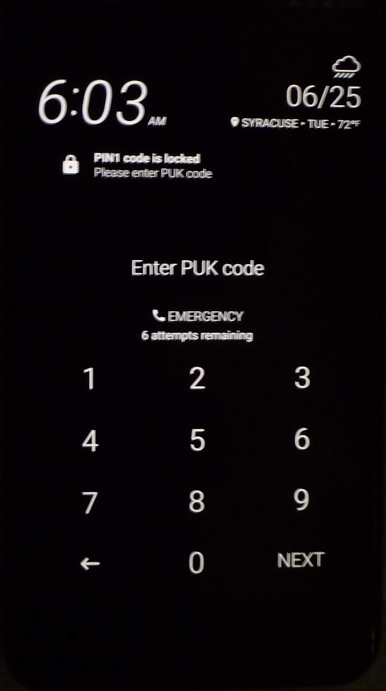

I received my new U11 a few days ago and have been working diligently to rebuild my application suite/config. It's been slow-going, tedious at times but generally not unenjoyable — that is, until about a ½·hr ago, when the proverbial f#c%l material hit the proverbial fan. Now, I think I may be completely screwed, but perhaps I'm wrong about that. I hope so . . .
I was in the security section and having created a screen unlock password and registering three fingerprints, I saw an option to secure my microSD contents with a pin num — which I attempted to do with a six-digit number.
This is where the fun… I mean horror show started.
I'm unclear as to some of the details. I'm not even sure if my six-digit SD-card PIN even registered properly. All I know is at some point I got asked to input that PIN, maybe as a confirmation of the six-digit PIN I was trying to establish . . . and . . . then I seemed to keep getting this screen:
(Click the above image to ENLARGE)
At some point when trying to get past this screen, I think I got a message (more than once) that my entry had to be exactly 8 characters in length. Well, I know that an 8-digit code is not what I entered — I thought I entered a 6-digit code — and that's when I started to panic and try crazy, desperate PIN codes. I started out with "10 attempts remaining" and now I'm down to 6!
I even tried powering off the phone and removing my microSD card but I got the same results. So, I put the card back in. I think now, I'll pull the card back out and see if I can access the contents — expecting to fail, of course.
As you can probably surmise, I'm really feeling desperate about this . . . so anything anyone can do to help — even if it's only to point me in the right direction — will be greatly appreciated.

ADDENDUM – As mentioned above, I have now removed the microSD card from my U11 and plugged it into my laptop . . . and . . . all the contents are accessible — much to my surprise and delight.
Thanks, Unforgiven. I'm starting to think I'm gonna have to do a factory reset and start over. That will suck. But something you said has given me an idea: perhaps when I, for the second time, entered the 1st two digits of my 6-digit number, the system read those as the last two digits of an 8-digit code. I don't expect this to work, but I'm gonna give it a try. Then I'll be down to "5 attempts remaining" — which makes me wonder, what happens when I expire all 5? I'm guessing at that point, I'll have no alternative but to do a factory reset. Like I said, that will suck.
Anyway, thanks for the input; at least now I know what "PUK" stands for.
I was wondering the same thing, but didn't want to recommend you burn one of your remaining attempts in case someone else had a better idea. I also considered that you would have had to enter the 6+first 2 twice, and figured that was a long shot. o_O

You get extra points for being diplomatic! I just realized that the reason my microSD contents are accessible is that I was fundamentally mistaken about what (if anything) I had encrypted. I thought I was modifying the microSD card, but I was modifying the SIM card — as you rightly (and most diplomatically) referred me to. ¶ So now I know I can get my phone working okay . . . I just have to take my SIM to VZW and swap it for a new one. Piece of cake, I think. The panic has begun to abate!

You weren't able to recover your PUK using the instructions in the link? You should still have a few attempts left.
